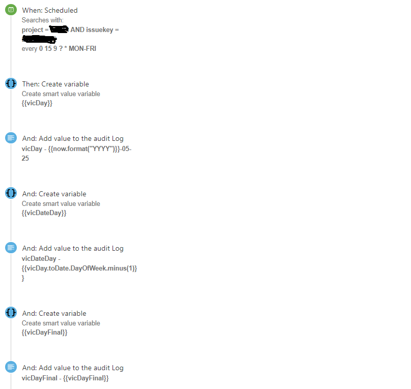

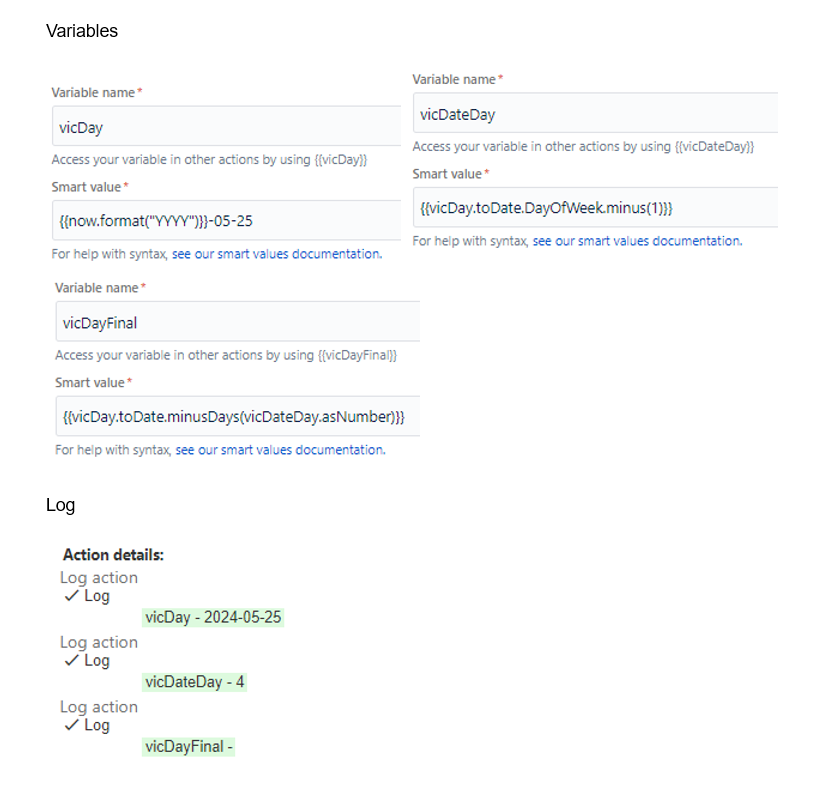

Anna
May 14, 2024
Bill, please find attached rule with detailstrigger flow.pngvariables and log.png
Bill Sheboy
May 14, 2024
Where you write the smart value expressions to the audit log, try writing the variables instead: {{vicDay}}, {{vicDateDay}}, and {{vicDayFinal}}
That will help confirm the variables contain what you expect.
Also, smart values are case-sensitive, and I believe the attribute DayOfWeek should be dayOfWeek: https://confluence.atlassian.com/automation/jira-smart-values-date-and-time-993924864.html#Jirasmartvaluesdateandtime-attributesAttributes
Anna
May 14, 2024
hi Bill, thanks a lot for your reply. I have fixed the case to dayOfWeek and always check each calculation in log when move to the next step. I added variable where argument is explicitly defined as number and it works:
{{vicDay.toDate.minusDays(vicDateDay.asNumber)}} - returns null
{{vicDay.toDate.minusDays(4)}} - returns 2024-05-20 as expected
so the issue is caused by variable argument.
