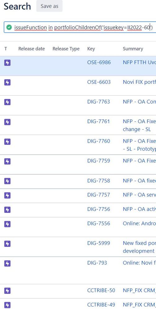

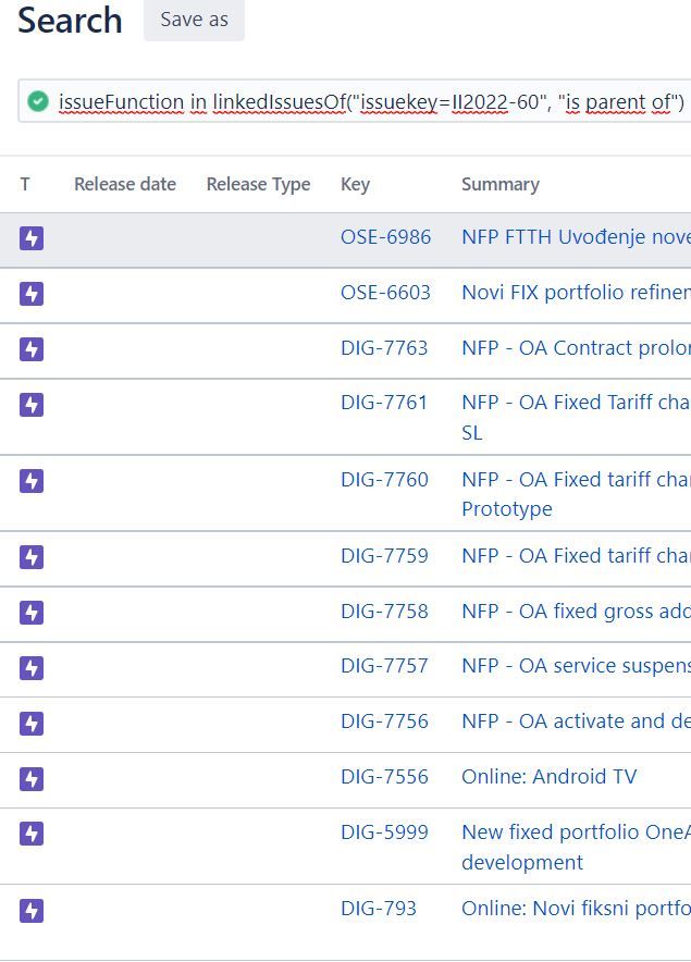

A filter using linkedissuesOf() is not working properly for me. It is not displaying all the issues. An initiative has 22 child epics, and linkedissuesOf() returns only 12. The 10 missing ones all belong to one new project, so I am not sure if there is some setup missing there.
issueFunction in portfolioChildrenOf('issuekey=x-1') =22 results
issueFunction in linkedIssuesOf("issuekey=x-1", "is parent of") =12 results

There are 22 issues linked with this same link (see screenshot 1). My understanding is linkedIssuesOf should return all these 22. New screenshot for reference, other issue links here are used for other stuff.
