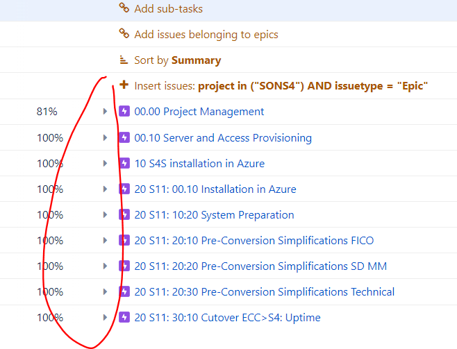

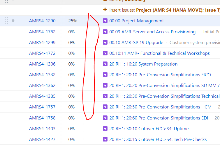

tengo problemas conmi estructura., no se porque no me estan apareciendos los task debajo de las epicsno picklist.PNGpicklist.PNG

From the screenshot, it looks like this is an issue with the placement of the Generators. They need to be applied to the structure and not under the Epic.
To properly apply Generators, please start with an empty structure (or delete the items in your current one) and do the following:
1. Click on the ‘Automation’ button (will be highlighted when activated)
2. Make sure you're focusing on the top level of your structure (the row with your structure's name)
3. Click on the "+" sign next to the Automation button
4. From the drop-down menu, select Insert > JQL Query: project = YourProject and issuetype = Epic
Then, you can repeat steps 1-3 to apply The Extenders and repeat the steps as needed.
I hope this helps.

@Brant Schroeder I think that may just be the way the two screenshots are lined up.
It does appear we are looking at two separate structures based on the start of the JQL that appears in the first screenshot and the second.
What we can't see is the Extend Issues Under Epics generator in the structure that does not show any issues under the Epic.
@Douglas Bojorge , could you check if this generator exists in the structure you are having trouble with?  It would also be worth checking the levels set in the generator if it does exist.
Hope this helps!
