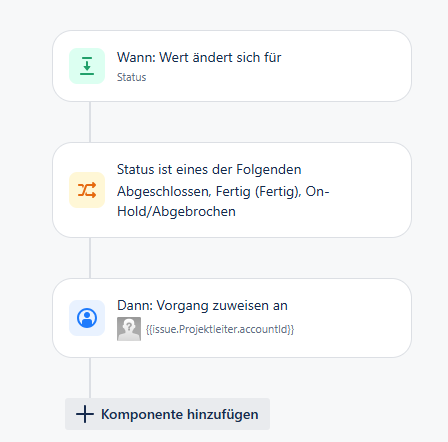

"I want to assign the issue to the issue assignee at the end of a project. I created a rule for this

I want to assign the issue to the issue assignee at the end of a project. I created a rule for this. However, the audit log keeps showing that 'The issue's assignee has already been cleared', even though it can't be due to the workflow, such as a post-function."

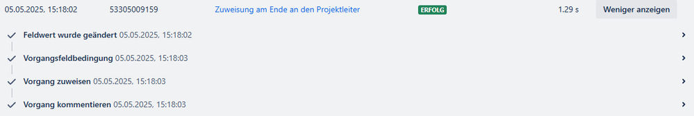

I explained it ambiguously. I don´t want the projectlead from the whole project. My firm has an custom field in every issue/ticket which is also named projectlead. I have already implemented it in my test board/project (there the rule works perfectly), but not yet in the main project, because the assigned user keeps being cleared. The audit log shows that the issue was assigned, but below it says 'The issue's assignee has already been cleared.' Unfortunately, this is in German on my screenshot.

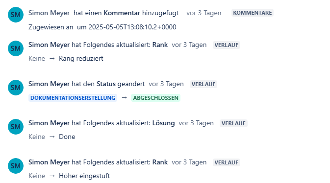

In my history, it doesn't show that the assignee was changed in any way. However, the audit log shows that the issue was assigned. Am I misunderstanding the audit log?

The issue is raised assigned to a user and a custom field is used to set the project lead (field Projektleiter).
What type of field is this, a user picker field or other?
The rule you have needs to set the field assignee to the user specified in the field Projecktleiter, correct?
The use of smart value, in the edit action, should work.
The audit log tells it's cancelled. Check the automaton history on the issue, are their no other rules active on the transition to any of the statuses mentioned in the rule.

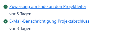

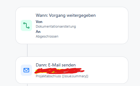

Only another automation rule has been triggered in the automation log in the issue. The first one is mine, which I already sent as a screenshot, and the second one is in the lower screenshot. This second rule is solely responsible for sending an email.

The history only shows that the status was changed, the rank was updated, and the resolution is now 'Done'.

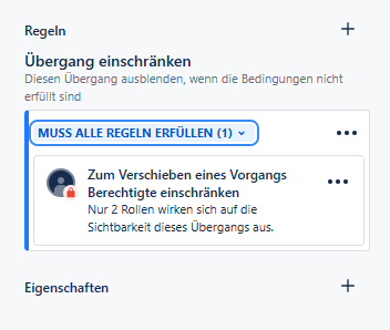

And the only rule on the transition is a condition restricting who can move the issues (see screenshot 2).
