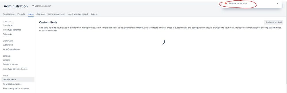

When I try to access Custom Fields, I get an Internal server error (attached screenshot), and custom fields are not displayed.
This started after trying to add a new custom field.
Trying to figure this out for more than a week but with no luck so far.
Tried the resolution suggested on https://community.atlassian.com/t5/Jira-questions/Internal-server-error-when-open-Custom-Fields/qaq-p/936744 but the query failed.
Any ideas would be appreciated.
Issue resolved!
Duplicate fields were found and deleted directly from the database.

I've created a support ticket for you. Please take a look at your email now for that ticket number.
Once the issue is resolved, please feel free to come back here and let us know what the resolution was so it can help users in the future.
Shannon
  Hi Sapniol,
Here I'm facing the same issue.
please suggest me.
Pramod
  I have ran the below query I didn't found any duplicate field in a screen:
select f.name, i.fieldidentifier, count(*)
from fieldscreen f, fieldscreenlayoutitem i, fieldscreentab t
where f.id = t.fieldscreen
and i.fieldscreentab = t.id
group by f.name, i.fieldidentifier having count(*) > 1;
