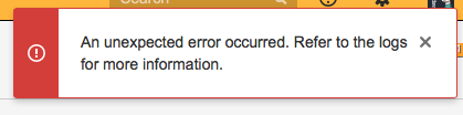

But when clicking on it, it shows me:
I can't figure out which logs I should take a look.

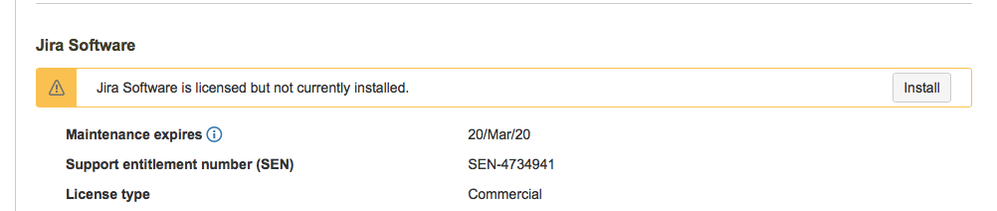

But there actually did happen something, because now for some reason the "Software" of Jira is not installed anymore..
See:

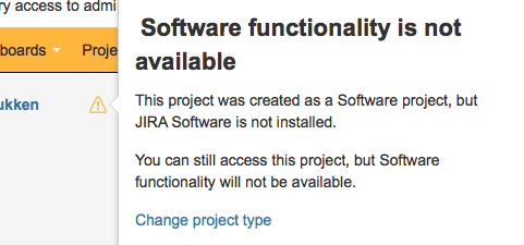

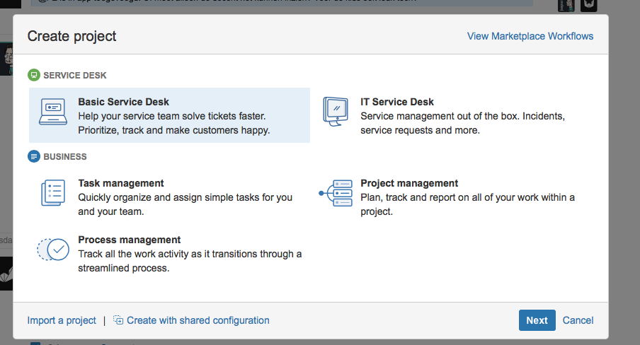

As you can see, when creating a new project, it's not available anymore:
But I use Jira only for Software development, so this is impacting our business a lot...!

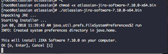

How did you upgrade your Jira instance? Did you do it from within the application?
I recommend you to use the installer. I've seen several situations in which users try to upgrade from within Jira and the upgrade fails for several reasons.
I think you can best upgrade by using this method.
Ricardo
Yes, from the application.
Tried to do it manually , but then I got this and no option to 'update'. Just to install it.
