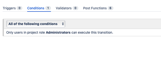

Condition:

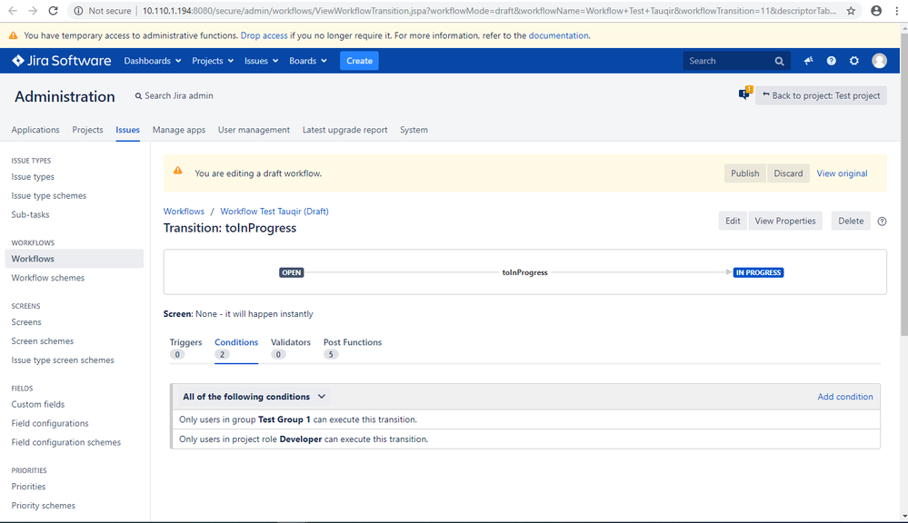

Project Roles configuration:
Hi Tauqir, maybe it is a Server condition but I don’t see “user in project role to execute a transition”. I do see “User Is In Any Project Role”. In any event could you share the following:
Thanks. Based upon what I see and assuming d1 and d2 are in the Test group 1 then they should be able to transition to in progress but no one else. Basically both conditions must be met.
so are you seeing all individuals in Test group 1 being able to transition even if they are not in the Developer role?
