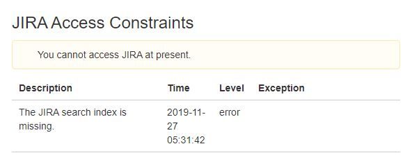

I am working on upgrading Jira for my project. So I replicated the existing Production instance ( v6.3.9#6) to make a dev instance and have pointed to DEV database that we already have for this upgrade. I brought up DEV Jira instance but while accessing I have getting "JIRA search index is missing error". Please let me know what I need to do for this error. My real intention is to upgrade our Production Jira to the latest. So I am trying to create dev instance and upgrage before I touch Prod. Quick response is most most welcome,
Kindly find the screenshot for the error.

I am assuming - there is a filesystem/path problem with your setup , can you verify your file paths ?
Your DB Config file is under ..../DEV/....
but your indexes are under ...../PROD/....
Is everything right out there ?
/opt/customer/Atlassian/DEV/Jira_Home/dbconfig.xml
/opt/customer/Atlassian/PROD/Jira_Home/caches/indexes]
Have you run a reindex already or not yet ?
Not yet. Since I am not not able to login and I see the above error in login page itself.
rename the current index directories that you have and restart the application - it should create a new set of index files by itself as it restarts and see how it goes.

Thanks for your response. I have already tried it with deleting and renaming index directory but still I am facing same issue.

I have taken exports of current Production setup cleanly and I don't think we have an issue there. As far ad DB is concerned, we already have separate DEV data created and given to me and I ma using that so I am not sure the full details for this. I will send you a logs of tomcat while brining it up. That would hopefully help to throw light and see picture clearly.

2019-12-02 00:53:15,035 localhost-startStop-1 INFO [atlassian.jira.upgrade.ConsistencyCheckImpl] Checking JIRA consistency
2019-12-02 00:53:15,061 localhost-startStop-1 ERROR [atlassian.jira.upgrade.ConsistencyCheckImpl] Indexing is turned on, but in
dex path [/opt/customer/Atlassian/PROD/Jira_Home/caches/indexes] invalid - disabling indexing
