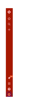

Andy Johnson January 22, 2019
Thanks @Angélica Luzfor pointing me in the right direction with regards to Parallel Sprints .
I couldn't find Parallel Sprints under the location listed in your link, instead for me it was located under >Settings>Products:
Then the Parallel Sprint management drop-down is located next to the Quick Filters:
Once the correct sprint has been selected the Complete Sprint button should become active once more and the sprint can be closed.
