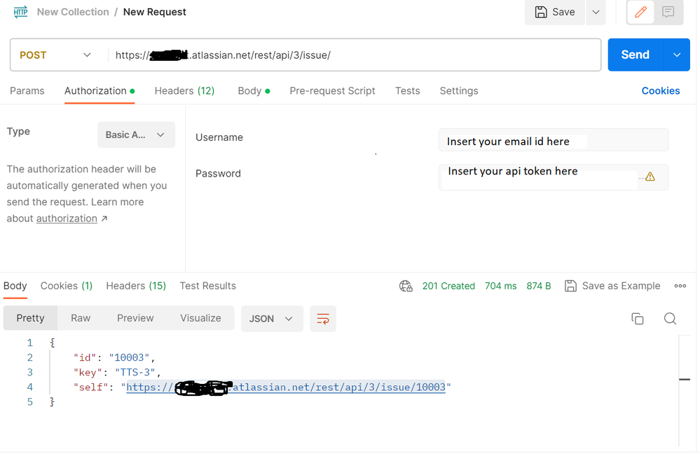

I am able to solve this issue, the problem is that you have to use the API token in basic auth instead of password. Here is the procedure for the benefit of everyone.
Create your token here: https://id.atlassian.com/manage-profile/security/api-tokens
Here is the body of the post-call:
You can refer to this video also, its very helpful: https://www.youtube.com/watch?v=pcNqjBlhipU&feature=youtu.be&ab_channel=HongLyTech
