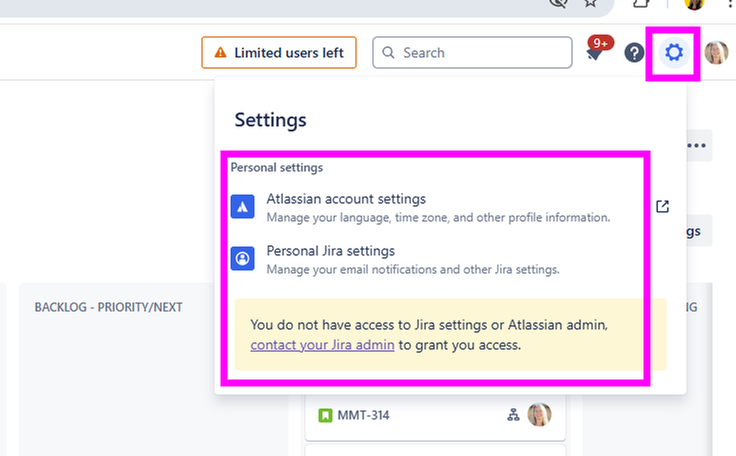

I am signed in to a FREE account, as user who is member of org-admins group, but no sign of Trash where it is supposed to appear under the Settings Cog top-right of screen
If I understand correctly, you are expecting to see the project trash, but unable to do so. I can see that you are an admin of one site, but it seems you are not an admin on two other Cloud sites. Could we start by trying first to confirm which site you are doing this on?
From your screenshots, I can see the id of the org in question, but these appear to be for a paid site where you are the admin. The other free plan sites your account is not an admin, and in turn I would not expect you to be able to access administration level features.
Perhaps if we can clarify which site you are trying to perform this on, we can better serve to direct you to the admin of that site, who can either perform this or if they choose to delegate admin role to your account.

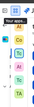

While logged in to the site where you are trying to find the admin settings and Project Trash bin, click on the Your apps button in the upper left corner.
That will show a list of the Atlassian Cloud Organizations to which you have access. If you hover over the highlighted tile with the border showing ("Tc" in my image) then the name of the Organization should display.
Provide that information to Andy here to let him know in which Organization you are looking for and not finding the Admin options.
If you could still access the project you could use the same steps above to determine in which Organization its parent Jira instance resides.

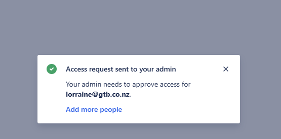

And Invites are lost in the mists somewhere...
thank you for trying to help - sadly that link tells me nothing useful, just waffles on for pages with nothing that seems even vaguely like what I am seeing, which is
Absolutely I did, and absolutely no sign of Trash in the drop-down:
While you may be an Organization Admin, your account has not been granted the Jira Administrator (or Jira Product Administrator) level of access. If you had that access you would see more options like System, Projects, and Issues.

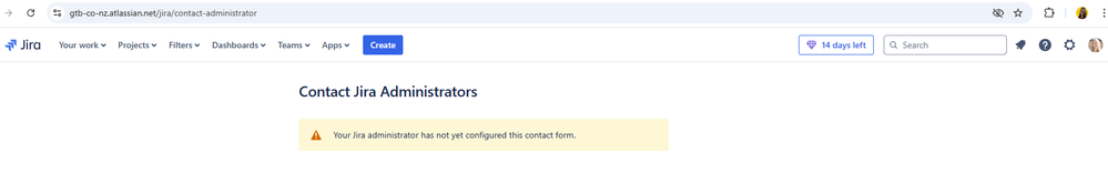

The document link I provided has instructions for how to grant a user administrative access to the Jira product. The specific steps depend on which user management model your Organization uses. Which is that for your Organization?
If you can walk through the instructions and provide screen images (obscuring confidential data) we can try to help guide you.

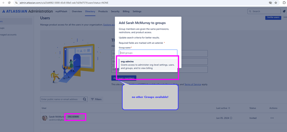

thank you @Trudy Claspill - the information in https://support.atlassian.com/user-management/docs/give-users-admin-permissions/  to Grant access does not work - I just get this stone wall:

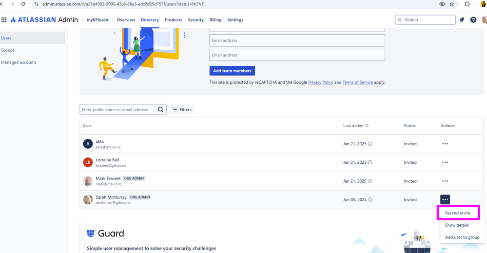

and when I Resend invite, NOTHING HAPPENS - no invite appears in Inbox, nor in Junk, nor Quarantine :-(

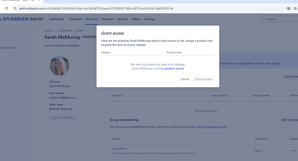

I see that you have another person specified as an Org Admin. Do they have the same experience as you?
If you drill into that user's account details, do they have any products listed? Are you able to grant them access to products?
