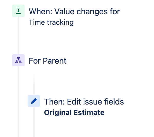

Created this rule for changing the Story Estimate when a sub task estimate changed
Action is: {{#=}}{{issue.subtasks.original estimate.sum}} / 60{{/}}

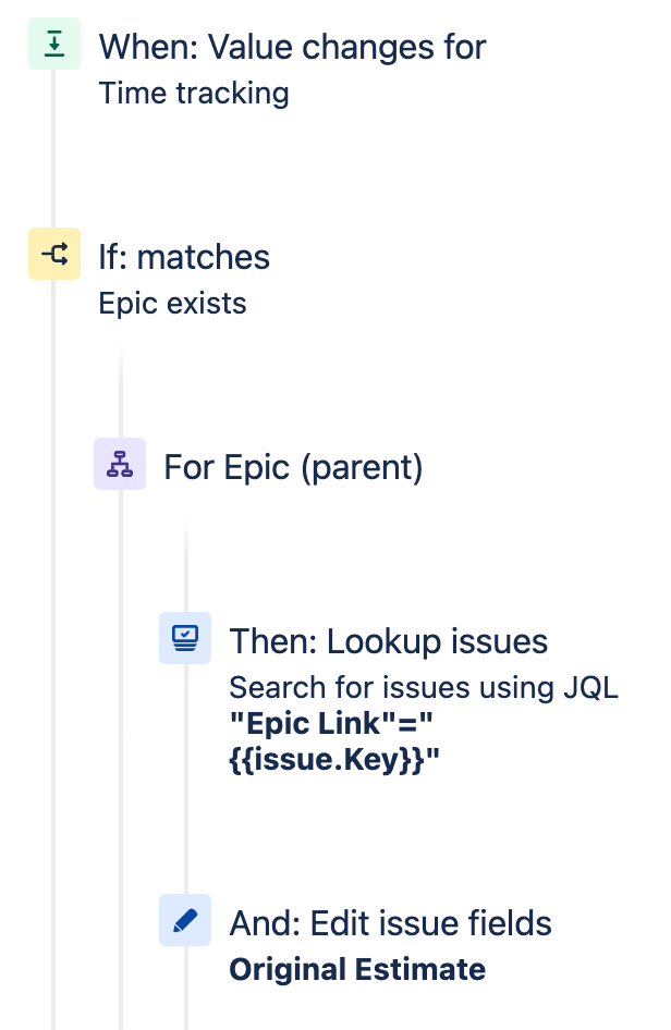

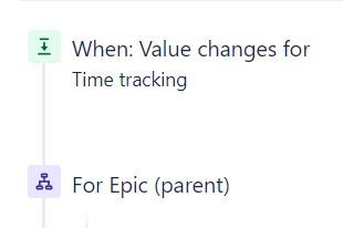

Created this rule for changing the Epic Estimate when Story estimate changes
In the last action step I used:
{{#=}}{{lookupIssues.original estimate.sum}} / 60{{/}}

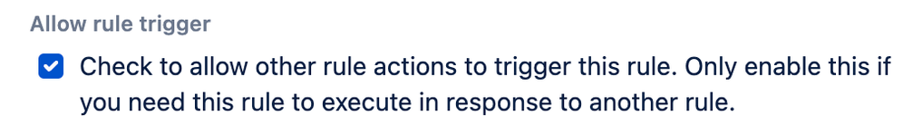

Make sure you allow the first rule to trigger the second rule by setting;
'Allow Trigger' in the rule details of the second (Update Epic) rule
