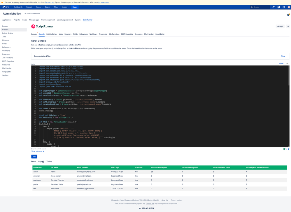

Below is a screenshot of the configuration for your reference:-
Since you are doing a check for 400 over users, the results will be truncated if you try to get them via the ScriptRunner console.
The best approach would be to use the email to add the result to the email body and as a CSV attachment.
I tested with 5 projects and 5 users in the test case I used. Of the 5 users, only one has access to all 5 projects, i.e. the Admin user. The others have access to only 4 projects.
Below is a screenshot of the example output that you should receive via email:-
