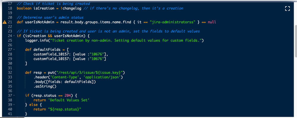

Hello, im using scriptrunner for restriction of customfield change by users that isnt members of jira-administrators group, on existing tickets it works fine, but now im trying to do it for new tickets, i dont know how to setup correct value of customfield, im getting error:
body: {"errorMessages":[],"errors":{"customfield_10157":"Specify a valid 'id' or 'name' for Internal Severity","customfield_10158":"Specify a valid 'id' or 'name' for External Severity"}}
what should i use as customfield value? or maybe im doing another mistake?

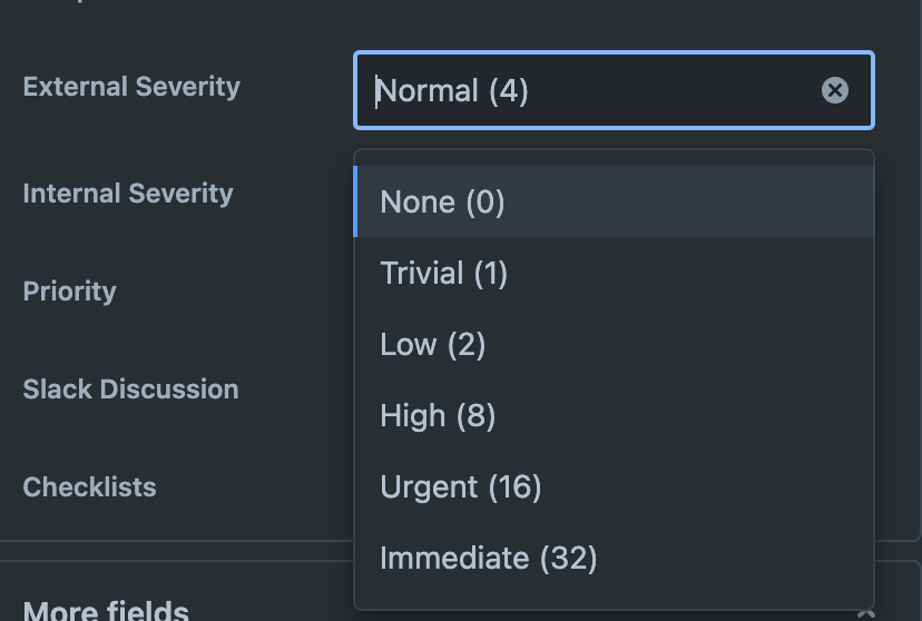

by api request im getting this values of this fields that i should use:
from:10676, fromString:None (0) tried to use both, but still no effect.

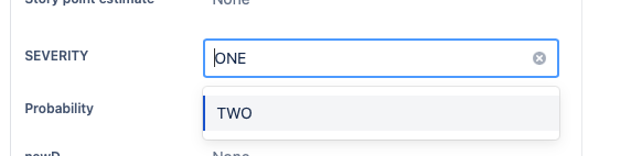

Hi again,
I think you should use the External Severity value , I mean, Trivial (1), Low (2) ..... For example, I checked with a cf called "Severity" which has two possible values , ONE or TWO. Check my screenshots for clarifying it.
I hope it helps.
Hi Alex,
I can see some possible issues in your code:
fields: [
(customField.id):[value: "<OptionValueHere>"] as Map
In addition, to get what you want, this way is not ideal, and you could avoid having to perform these checks and conditions to see if the issue is being created or already exists by simply using two script listeners, one for the "issue created" event and another for the "issue updated" event.

Thanks for answer!
I know about group name and same id for customfields, already fixed it.
But for this error:
still same, im using your example right?
def resp1 = put("/rest/api/3/issue/${issue.key}")
.header('Content-Type', 'application/json')
.body([
fields: [
(customfield_10157):[value: 10676] as Map
.asString()
this customfield is dropdown list of fixed values: i checked available values by api request and found 2 usefull id for needed default value:
