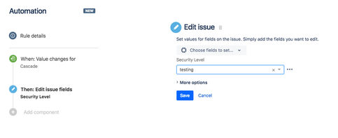

Hello Saroja,
You can use Automation for JIRA to achieve this kind of functionality:
Please, let me know if this option works for you.
