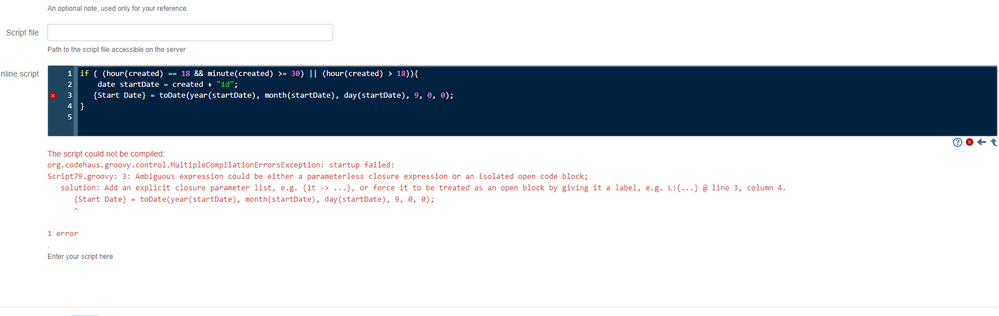

After adding your script to my script create transition, I get this error:

You ve got the ScriptRunner add-on. But I gave a script for the Power Scripts add-on:
I do not have a script for ScriptRunner.
thx
that won t help me cause i have a sriptrunner add-on
thx again

Your script will be like this:
if ( (hour(created) == 18 && minute(created) >= 30) || (hour(created) > 18)){
date startDate = created + "1d";
#{Start Date} = toDate(year(startDate), month(startDate), day(startDate), 8, 0, 0);
