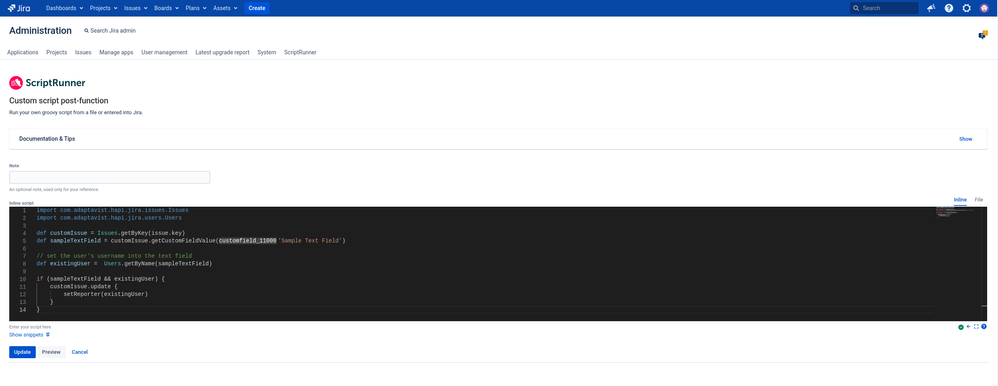

Below is a screenshot of the Post-Function configuration:-

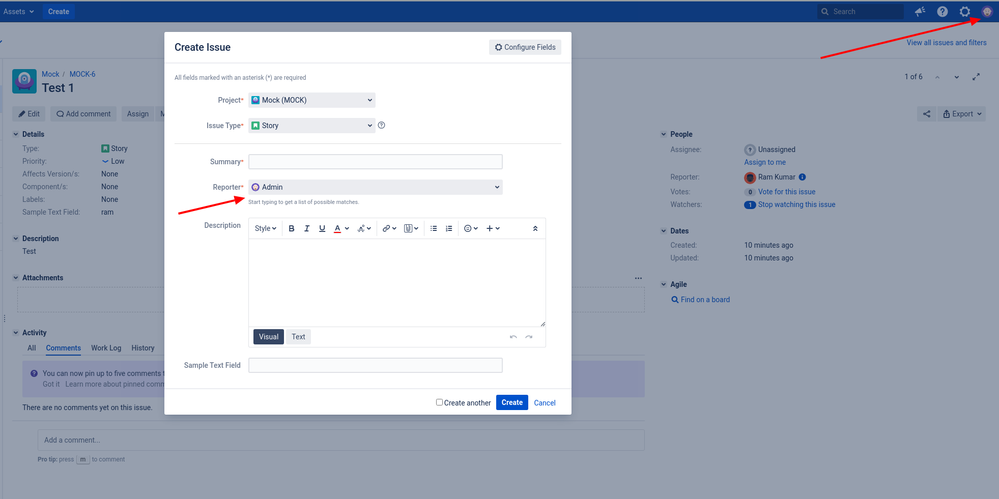

1. When creating a new issue, the Reporter field is set to the currently logged-in user by default, as shown in the screenshot below:-

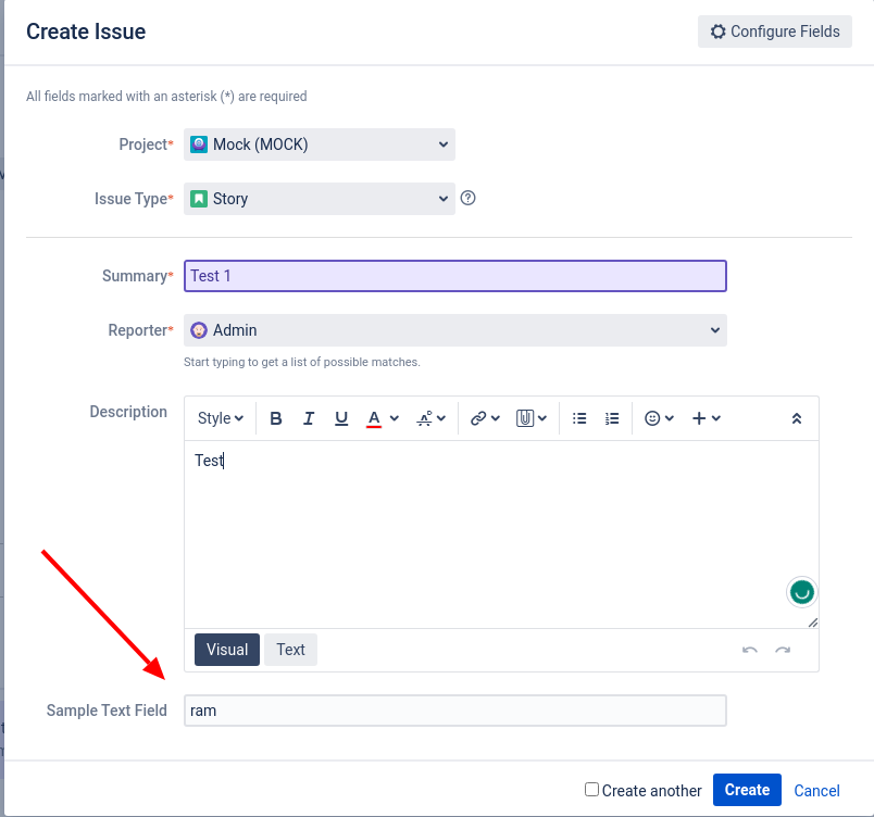

2. On the create screen, the Sample Text Field is updated with a valid username as shown in the screenshot below:-

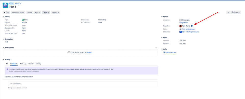

3. As expected, the reporter field is updated accordingly once the issue has been created, as shown in the screenshot below:-

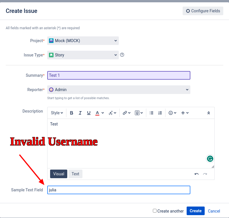

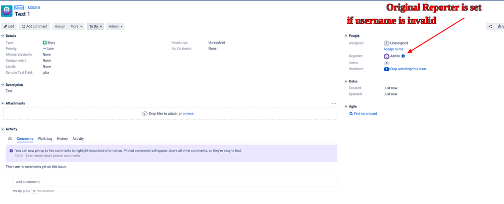

4. In the next test, an invalid username will be added to the Sample Text Field, as shown in the screenshot below. The user julia doesn't exist.
5. As expected, once the issue has been created, the reporter is set to the original reporter currently, i.e. the Admin user.
