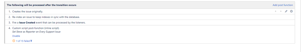

and place your postfunction before change history postfunction.

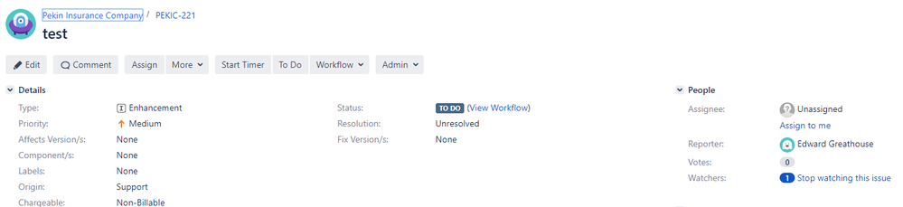

However, the issue still has the reporter as me when I create it. We are getting close. I will post screenshots of where I have the post function and the issue I tested it with.

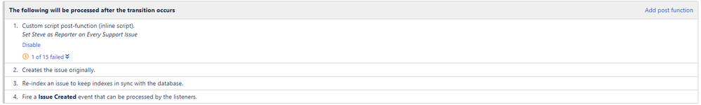

Hi @Mark Markov,
I fixed it by adding the post funciton to the top of the que. Thank you so much for all the help!
Fixed!
Once I moved the post function to the top of the list, I now see "Steve Thomson" as the reporter.
