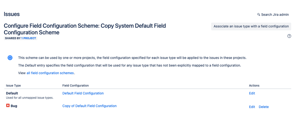

The best solution is to create a new Field Configuration where the Affects Version field is set to Required.
Then create a new Field Configuration Scheme. In that Scheme, make the original Field Configuration the default. Then add your new Field Configuration to the Scheme associating it to only the Bug issue type.
Then apply the new Field Configuration Scheme to the five projects.
Here is an example of what the new Field Configuration Scheme might look like:

You'll want to create a brand new field configuration.  In this new field configuration, you'll want to find the Affects version field and click on required.
From there, you'll want to create a new field configuration scheme.  Then you want to click on Associate an issue type with a field configuration at the top right corner
Select Bug and then select the field configuration that we made in the first step.  Click Add.
So at this point, you should have a field configuration for just bug and then the default field configuration for everything else.
Finally, go into your project(s) and go to project settings -> issues -> Fields -> Actions.
Click on use a different scheme and select your new field configuration scheme.  Do this for the other 4 projects.

Thank you both for your quick and excellent responses. You made the solution sound so easy, and it was it! Kudos to both of you!
Now, I have a solution and have learned something new. Thank you both for sharing your knowledge. It is very appreciated!
