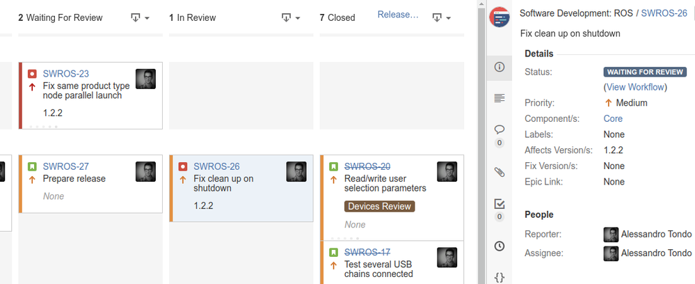

However today I've faced it with a default issue type (i.e. not sub-task as said in the first post). Here are few screens to let you understand better:
As you may understand, SWROS-26 should lay in the "Waiting for Review" column as shown in the summary on the right, but after the transition by drag-and-drop from "In Review" to "Waiting for Review", it has not changed the column together with its state.
And by drag-and-drop I can only move it to the last column, i.e. "Closed", but not again in the "In Review" column.
Nothing changes with reloading and reindexing.
Fabio Racobaldo _Catworkx_
April 5, 2018

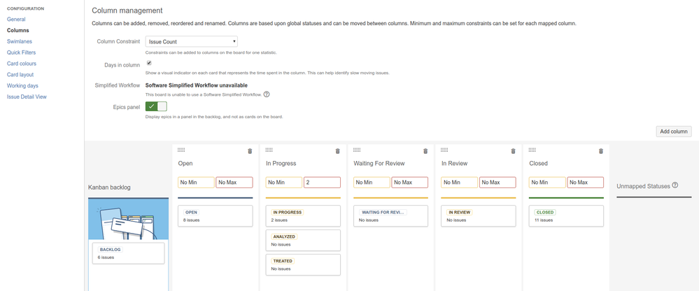

please could you show me the column configuration?
Alessandro Tondo
April 5, 2018
Here you are:
Is there anything wrong? (Analyzed and Treated states are relative to another workflow not yet used)
April 5, 2018
Hi Alessandro,
reviewing your configuration (that seems ok), I don't understand why SWROS-26 appears in the column "In Review" even if its status is "Waiting for Review" that should be mapped into "Waiting for Review" column.
In my opinion there are some issues at index level.
