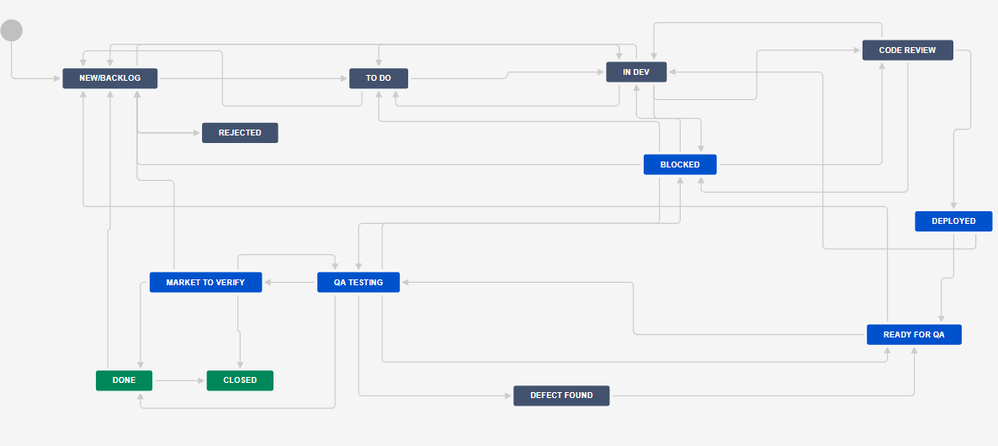

This is the snippet of the workflow.

This is related to the design of the workflow being used for story and change request in your instance.
Through project settings > workflows see what workflow is being used for those issue types.
When you edit the workflow and select the transition that currently prompts you to set the resolution, you will see 2 things:
As it seems you want this to happen on another transition in your workflow, remove both the validator and the transition screen. But definitely add them again in the exact same way on the transition that you think should be the closing transition in the workflow.
After making the changes, publish your workflow and you should be good to go.
