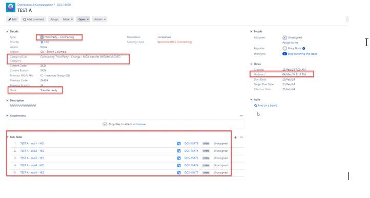

To provide assistance with an automation rule, we are going to need to actually see the rule you want to modify. Please provide screen images showing the rule.
Mary Mark March 7, 2024
Hi @Trudy Claspill
Please see details
Automation Query
project = DCS AND issuetype in ("Third Party - Contracting") AND "Category/Sub-Category" in cascadeOption("Contracting Third Party - Change", "MGA transfer (MGAMC/SGMC)") AND State = "Transfer ready" AND updated >= -1d AND updated <= 1d
Using this ticket as example: TEST A meets the criteria of the filter

By running the rule, the ticket got updated:
DCS-15941 is the new cloned parent
Source issue type is cloned to target issue type properly and category/sub-category is updated properly. Everything seem to clone over successfully along with sub-tasks. The only thing is that the new cloned sub-tasks should transitioned to “Closed” status
