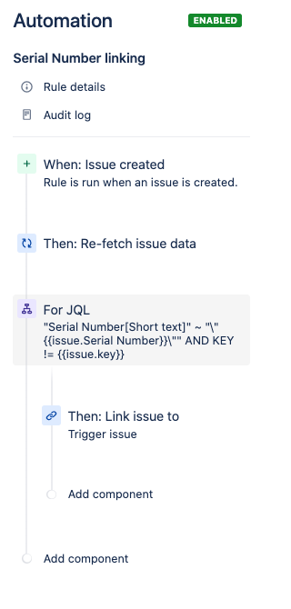

First I created a custom field named "Serial Number" of type "text", Noting that a text field will allow for alpha Numeric entry such as "ABC123". Then I added it to the appropriate field configurations for the project, then I created an Issue link called "Duplicate Serial Number" as shown below:
the Automation Rule I came up with will create variable smart values that can be used in a JQL search on a branch Rule operation, and link to matching issues found in the result set. I set the rule up as follows:
"Serial Number[Short text]" ~ "\"{{issue.Serial Number}}\"" AND KEY != {{issue.key}}
