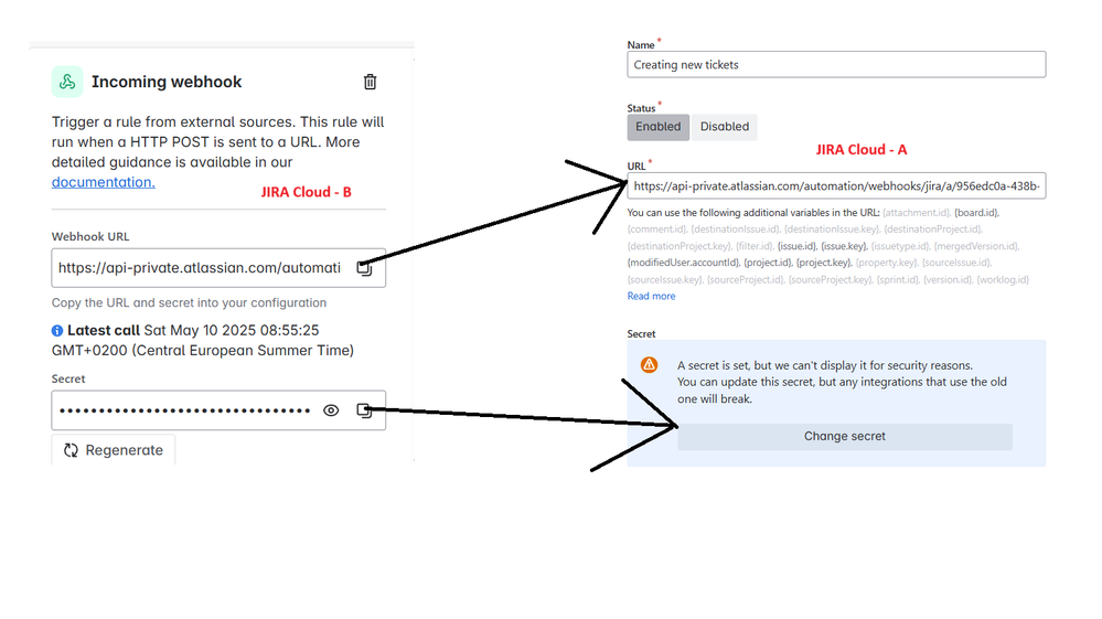

×I am just testing webhooks between 2 instances of JIRA Cloud - jirasource.atlassian.net and jiradestination.atlassian.net. On JIRA Destination, the webhook url given to me is "https://api-private.atlassian.com/automation/webhooks/jira/a/95xxxx-xxxx" and a secret key which I am passing both to jirasource webhook URL and Secret.
When I create a item in jirasource, nothing happens in jiradestination.
I have tested with curl and it works. So I am assuming the problem is in the way I have configured the jirasource... But the way I did it it just copy/paste of webhook url and secret into the webhook.
It does not work.. I cannot receive a webhook triggered from JIRA it seems.

Thanks Piyush for your replay. No issue with curl commands. In the JIRA webhook, I copied the url I am given by my automation starting with https://api-private.atlassian.com/automation/webhooks/jira/a/ and I add the secret key. See picture:

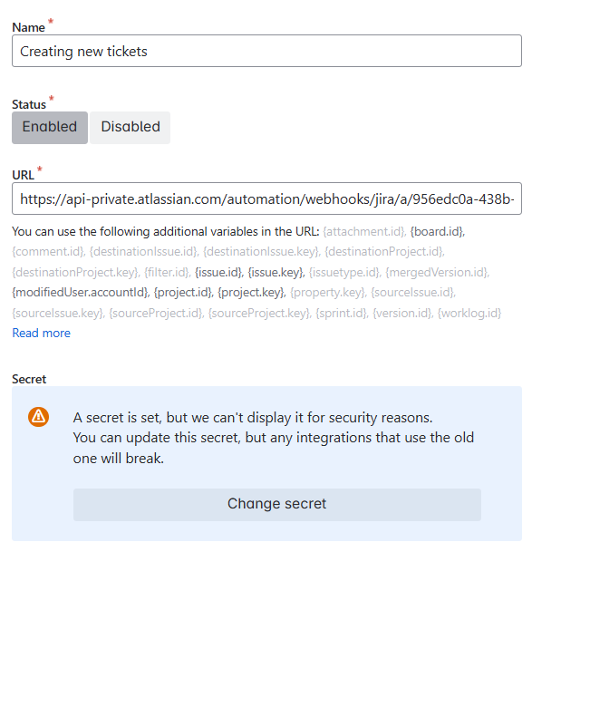

Thanks Michael for your reply: I have created a webhook from JIRA but how do I add this X-Automation-Webhook-Token header? I can create a ticket using a script but that is outisde JIRA. Curl commands work. What does not work is creating the webhook from JIRA to trigger a incoming webhook on the "destination" JIRA (knowing that everything works with webhooksite.com) - Below how I am creating my webhook in JIRA.
with a script, url and secret, it works. From JIRA: KO.

Good news - do you have a screeshot to show how to you did "webhook using URL/SECRET?issue=${issue.key}"? where did you put that?
Thanks in advance !
System settings -> Webhooks -> URL
Then I'm using this webhook in workflow's action "Trigger webhook". But in general, you can use this url schema everywhere you can't set url headers (for setting the secret). Then just pass secret as a part of webhook's url.
