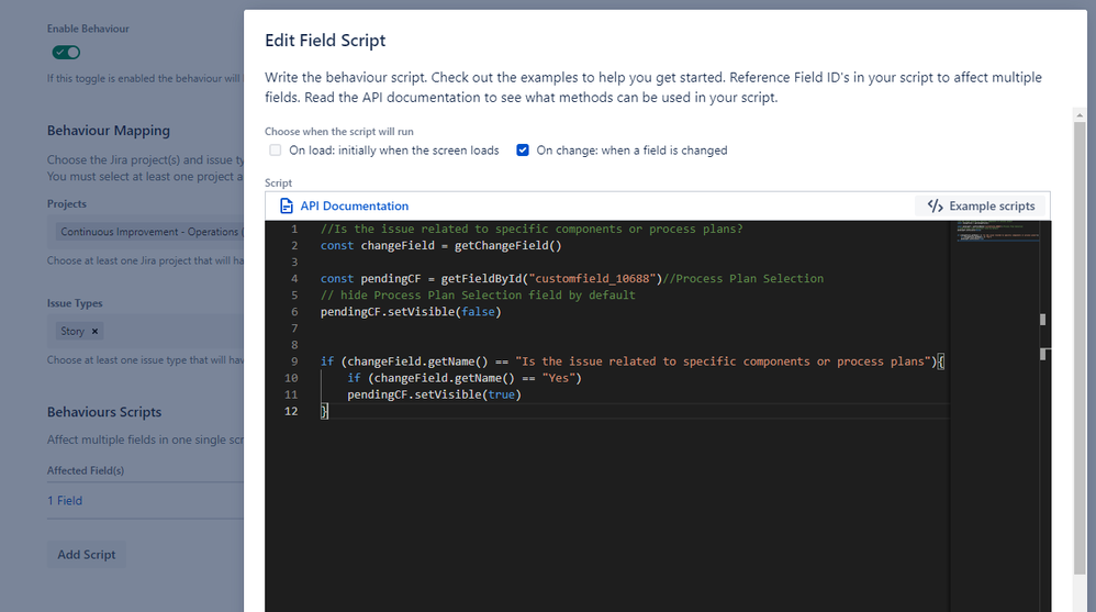

Yeah, i found documentation on it. but i cant change any fields visibility. this particaular field throws an error. but even other fields dont work. even with no errors.

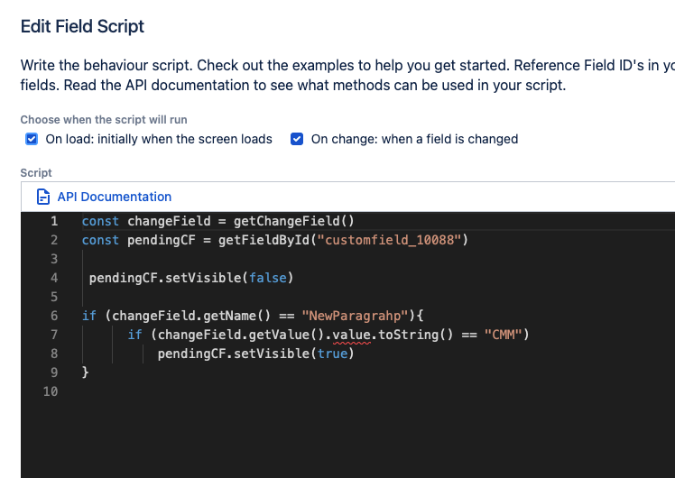

Joaquin Fernández Morales
August 25, 2023 edited
The code could be similar to the next:
const changeField = getChangeField()
const pendingCF = getFieldById("customfield_10687")
// hidden the field by default
pendingCF.setVisible(false)
if (changeField.getName() == "TheChangedCustomFieldName"){
if (changeField.getValue().value.toString() == "TheChangedCustomFieldValue")
pendingCF.setVisible(true)
Please, change in the previous code the : TheChangedCustomFieldName and TheChangedCustomFieldValue by yours.
I hope it helps.

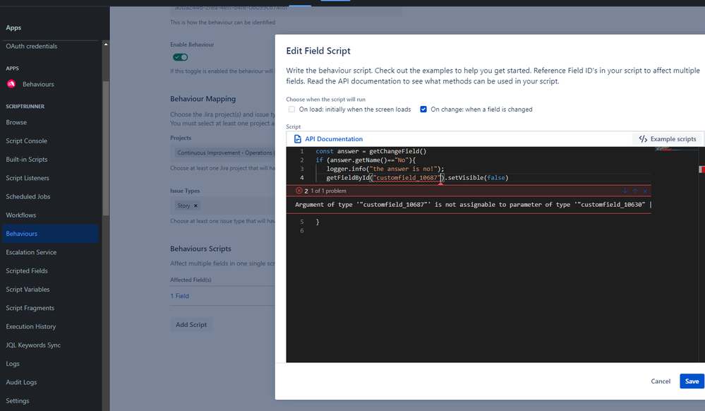

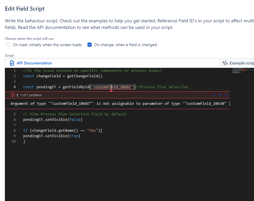

This was a great help as it partially works.
for my multiselect field i get an error. (screen shot attached). i went around it by using another custom field and it works. so something about the multiselect field is not right.

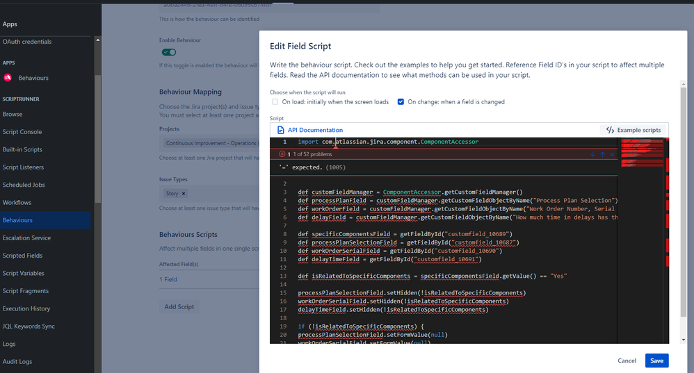

So create a new behaviour, set it to the specific project and issue type, it will need to be a server side script triggered when the form loads.
We had script runner removed so cant test for you and you should test outside your production environment.
I did ask Chat GPT to clean my code as i always use to do.
def customFieldManager = ComponentAccessor.getCustomFieldManager()
def processPlanField = customFieldManager.getCustomFieldObjectByName("Process Plan Selection")
def workOrderField = customFieldManager.getCustomFieldObjectByName("Work Order Number, Serial Number")
def delayField = customFieldManager.getCustomFieldObjectByName("How much time in delays has this issue caused or would have caused?")
def specificComponentsField = getFieldById("customfield_10689")

Ramez Kaupak August 25, 2023
I tried with ChatGPT. no luck. seems its using wrong language
