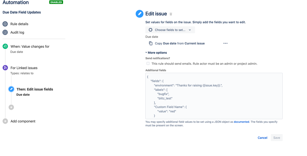

I have some automation rules set up to update some fields. So if due date is updated in an issue then the related linked issue due date field is updated too. It appears as succesful in the audit log but i do not see the change. The boards even say there has been a rule applied and to refresh, but still can not see the correct dates populated.
Please Help

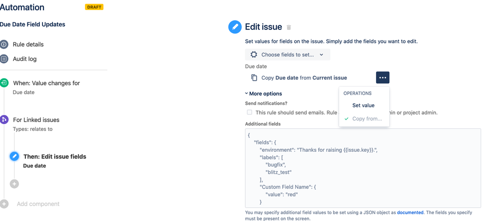

Thank you for the response. Please see attached. It is happening with all automation with fields. The audit log says its been successful but i do not see it on the boards.
Thank you for the response. Please see attached. It is happening with all automation with fields. The audit log says its been successful but I do not see it on the boards.

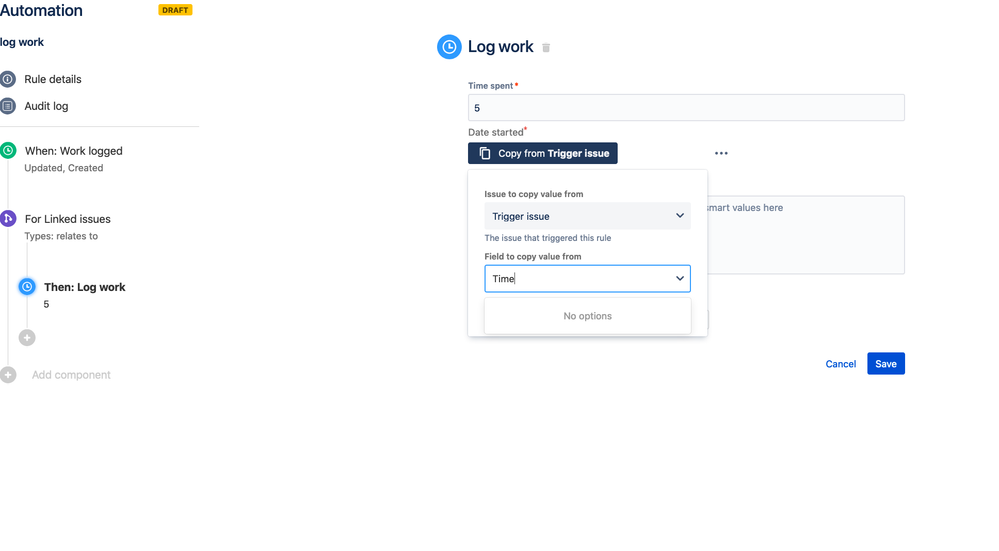

thank you so much seems to have worked. Are you able to advise pls if the below is the same issue. Tried to set it to trigger issue. Its updating time logs for anytime time is logged on a issue, i want the value to update the same on the linked issue? something to do with the time spent field :/. Cheers
Great! Glad I could help!

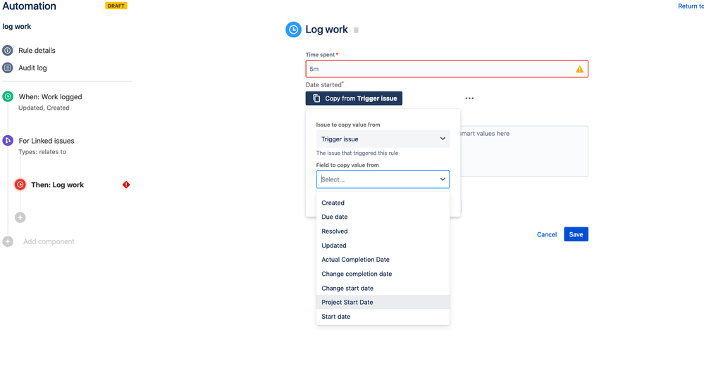

It looks like you are trying to set the value for Time Spent instead of Copying from the Trigger issue.
Is Time Spent not available instead of Created in your screenshot? You want to copy the Time Spent field from the Trigger issue. Correct?

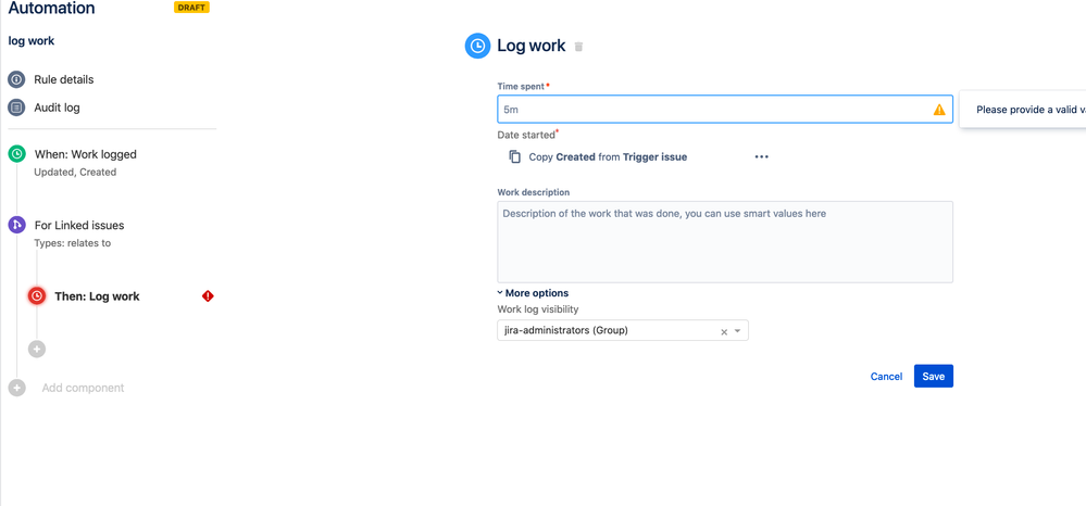

i see the below error when adding time on EAG-63 which is linked to PL-46, PL-46 timelog is not updated when i open tempo to view time logged against task
Hi @jinali-p (thanks @John Funk )
I suspect this error might be because you are using the third party plugin Tempo to do the logging of work.
At the moment, you can't log work with the Tempo plugin via automation: https://codebarrel.atlassian.net/browse/AUT-1269
I may be wrong so it is certainly worth putting a question through to support but I believe that is the issue here.

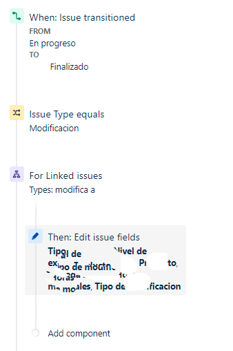

Im the same problem. This is my config:
Local rule in a project, run over issuetypes linked in the same project:
The log of rule run success. But not update fields.
The "atlassian-addons-project-access" is enable in permission schema for all permissions.
The screen for edit is the same for both issuetypes.
Sorry, resolved with "copy from trigger issue". ;-)
