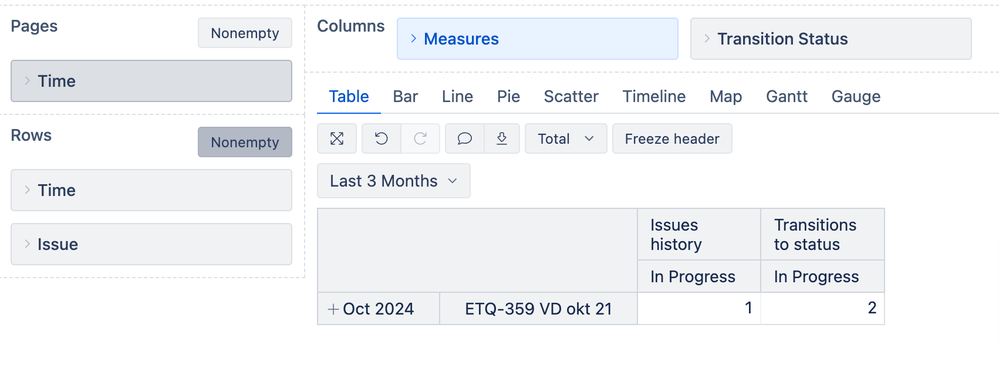

In this context, measure Issue history counts how many issues are in each status at the end of each time period.
Transitions to Status - How many times during selected Time dimension period issue has been transitioned to the status that is selected in Transition Status dimension
To visualize:
I have this one issue key ETQ-259 which shows value 1 against "Issues history" Transition Status "In Progress" and it shows value 2 against measure "Transitions to Status"
Against Issues history it shows 1, because in the Selected Time period (end of this period), it finds that there is 1 issue in the particular Status.
However, against measure "Transitions to Status" it shows 2, because in October this issue transitioned to the Status "In Progress" 2 times
I hope this clarifies your question!
