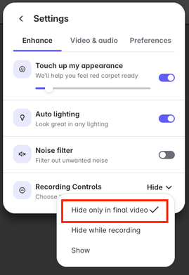

Hi @Vlad Zhigulin,
Have you checked which recording controls setting you’re using?
  • If you selected "Hide while recording", you’ll get the behavior you’re seeing: the Loom interface disappears completely and clicking the app won’t bring it back.
  • But if you switch to "Hide only in final video", the controls will stay visible during the recording.

Thank you so much, Manon!
I’ve been using the app for quite some time, but somehow this slipped past me. I just tested it, and it’s exactly what I was looking for. Thanks again!
