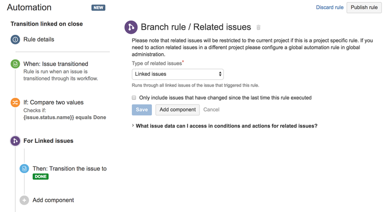

Scott Harwood
October 18, 2017
[project A] if the linked issue is closed, transition the issue to another status.
You should be able to use the same kind of rule for your other conditions also. Let me know if you need any help crafting them.
Cheers,
Scott

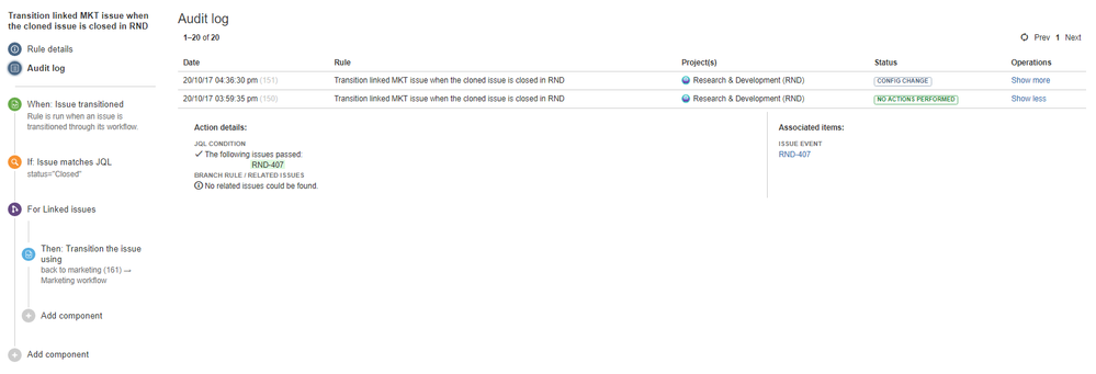

October 23, 2017 edited
Hi Scott,
I have just tried what you have described but there is still something missing. The audit log says that "No related issues could be found". I believe it simply says there is no link found in the RND-407? But actually there is a linked issue. Can you shed some light please?
Note that the linked issue is in another project.
