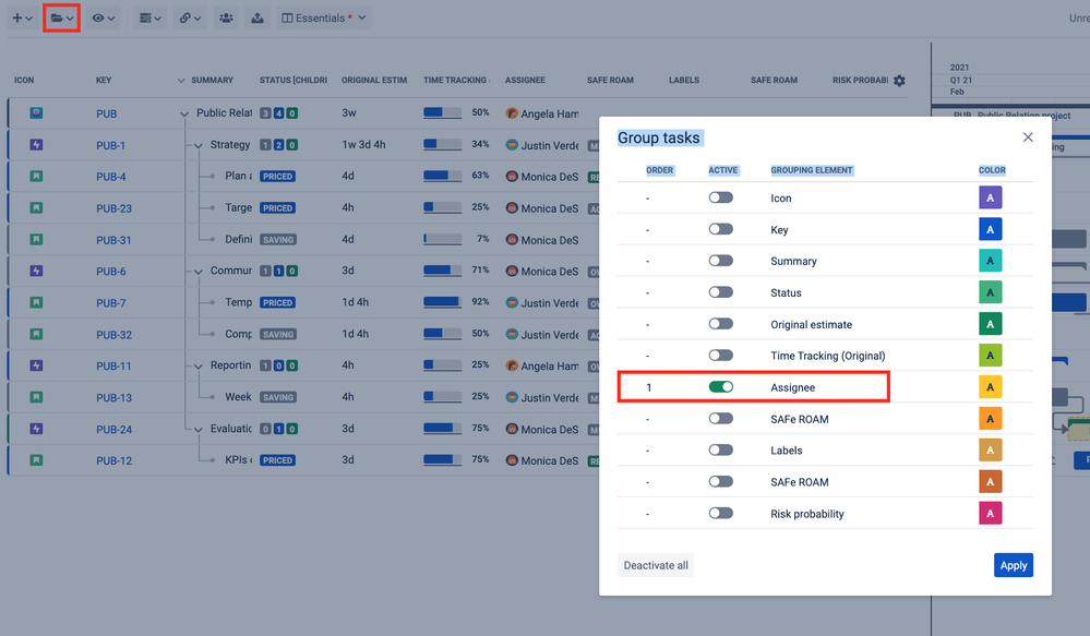

The grouping option helps to display and aggregate values on a selected field value level. Moreover, you can use multilevel grouping, where the group structure will be based on the active grouping elements, and the order of grouping elements (fields) determines the group hierarchy.
Indeed, the first step to group your issues is to add a given field to the column view.
To add a new column (that you want to use as a grouping activator later on), please click on the cog icon, find a given field and simply click it to add. See my image as a reference.
Once the field is added, it will appear on the grouping activator list in Data >> Group task.
Please let me know if you have more detailed questions.

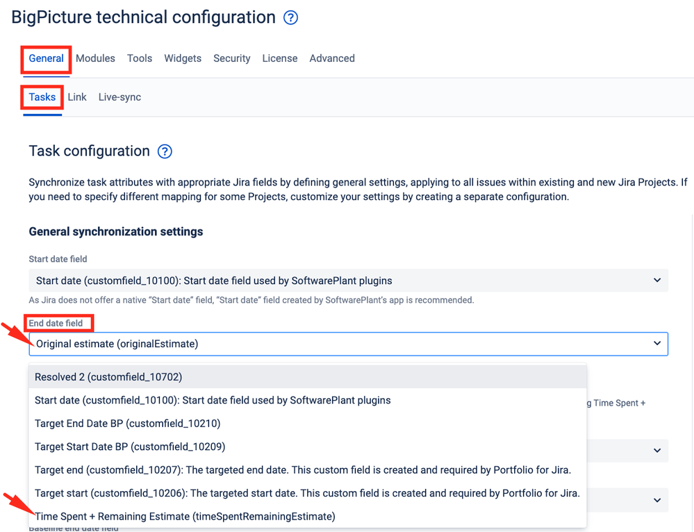

Currently, the plugin can automatically calculate the End Date based on the Original Estimate (or Time Spent + Remaining Estimate). Then the duration would be the value of the Original Estimate field (respectively Time Spent + Remaining Estimate). What you have to do is mapping the End Date to the selected field in Jira Administration >> Manage Apps >> BigGantt Technical Configuration >> General >> Tasks.
