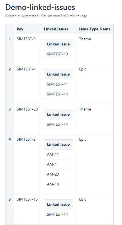

We were able to achieve this use case using the JSON macro. Please refer to the below example, here you can get the issue key, type and linked issues in a table which are extracted from REST API. You can copy the below storage format and modify your project and issue keys accordingly.
Please refer to the below screenshot for the same:
Here is the storage format of the example that we have tested in our instance.
{code}
<ac:structured-macro ac:macro-id="00384471-9938-4c5e-909f-ce7b7db48ed3" ac:name="json-table" ac:schema-version="1">
<ac:parameter ac:name="sortDescending">true</ac:parameter>
<ac:parameter ac:name="autoNumber">true</ac:parameter>
<ac:parameter ac:name="capitalize">false</ac:parameter>
<ac:parameter ac:name="headingAugments">key,Linked issues, Issue Type Name</ac:parameter>
<ac:parameter ac:name="url">https://abcd.efgh.com/rest/api/2/search?jql=project%20%3D%20test%20and%20issuetype%20%3D%20epic</ac:parameter>
<ac:parameter ac:name="atlassian-macro-output-type">INLINE</ac:parameter>
<ac:parameter ac:name="output">wiki</ac:parameter>
<ac:parameter ac:name="columnStyles"/>
<ac:parameter ac:name="fieldPaths">key,fields.issuelinks[*].inwardIssue.key,fields.issuetype.name</ac:parameter>
<ac:parameter ac:name="password">automation</ac:parameter>
<ac:parameter ac:name="sortColumn">1</ac:parameter>
<ac:parameter ac:name="paths">issues</ac:parameter>
<ac:parameter ac:name="user">automation</ac:parameter>
<ac:parameter ac:name="augments">,"%[%json-table:table=true%!%headingAugments=Linked Issue%]%%2%%[%json-table%]%"</ac:parameter>
</ac:structured-macro>
{code}
