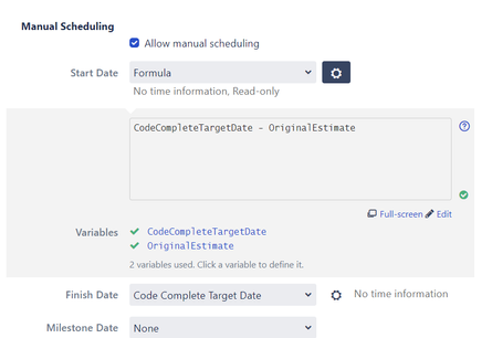

I have configured my Gantt for structure to use manual scheduling and my Finish date is based on a formula that uses custom field. I want the Gantt to calculate the start date using the finish date and the "Original Estimate".
My task bars correctly pick may custom field to use as the finish date, but the start date is not calculated on the basis of formula I entered (Gantt Finish date - original Estimate).
I have two other issues: a) I was able to use a variable called OriginalEstimate and set it to Original Estimate in the formula for start date but cannot find it in standard attributes when I try to use it to set fixed duration based in that section b) I don't know if need to use work estimates section preceding the manual scheduling at all.
I thought I will post some snapshots of my configs. Here is issue configuration.
image.png H
Here is my Gantt scheduling configuration

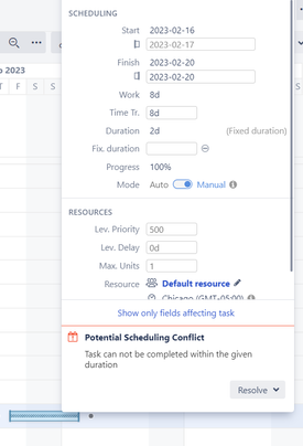

And finally, here is how it appears on the gantt chart

Hello @Surekha Gupta ,
For the formula, you will want to use the JIRADAYS function to convert the original estimate into strictly days and then use the DATE_SUBTRACT function to count back from your end date the number of days returned.
Something like this:
DATE_SUBTRACT(codecompletetargetdate,JIRADAYS(OriginalEstimate),"day")
For problem a) this is due to how that particular field is formatted.  You can try using the formula below.  That being said, your duration is going to come from your end date and formula above, so you probably just want to leave it set to "Store in Gantt chart"
For problem b) if you're always going to have the Finish Date and Original Estimate populated for each issue, you probably do not need to use Work Estimates.  You can leave them as is and know that if you see them being used it is most likely because one of the fields I mentioned is not populated.

Hi David, I was trying to do resource levelling and realized that when I use the formula '
Then I am counting calendar days instead of working days. How can I set my start date to be "Original Estimate" worth of working days before the end date?
