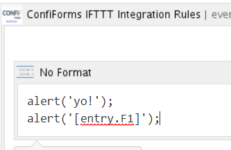

You are ahead of me. I am still trying to figure out hoe to get the basic alert working per https://wiki.vertuna.com/display/CONFIFORMS/Configuring+ConfiForms+IFTTT+actions :(
The wiki indicates to use a script fragment like below in the body:However this does not work at all, instead the following gets inserted into the page after execution:
This happens with or without the "no format" macro.
And then I simply ignored the wiki and voila! The following worked:
Previously (without the No Format macro) I could only get 1 line of JS to execute. Problem solved hopefully
Wow, not sure how you figure that out. It worked like a charm. I was able to display the form field I needed in the alert message as well!
