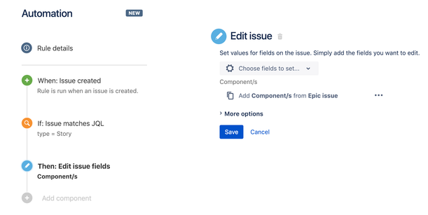

andreas
February 21, 2019
Hi Adriana,
yes this should be possible with a fairly simple rule:
So basically when a Story is created, this rule will edit the story and copy the components from the Epic.  This rule requires though that the 'Epic link' is already established when the story is created.
Otherwise, if you are linking the Story to an epic after creation you could also use the 'Field Value Changed trigger' with the Epic link field.
Hope that helps.
