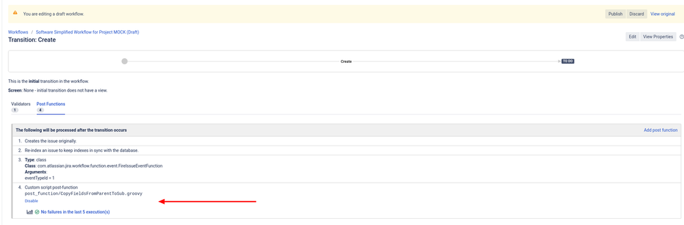

Below is a screenshot of the Post-Function configuration:-
This post-function sample is added to the Create transition and is added to the very bottom, as shown in the image below:-

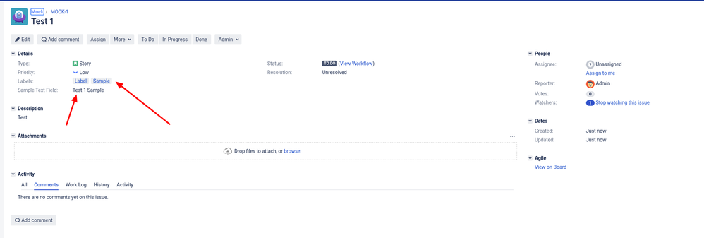

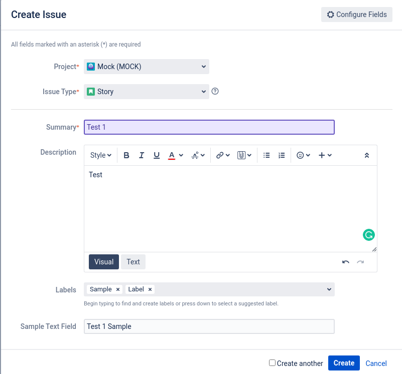

Below are a few test screenshots:-
1. A story-type issue is created, and some labels and a value for the Sample Text Field are added.
2. Once the issue is created, the value for the text field and the labels are visible
3. Next, a subtask is created. Only the Summary is added.
4. Once the subtask is created as expected, the values for the labels and sample text field are also included in the subtask.

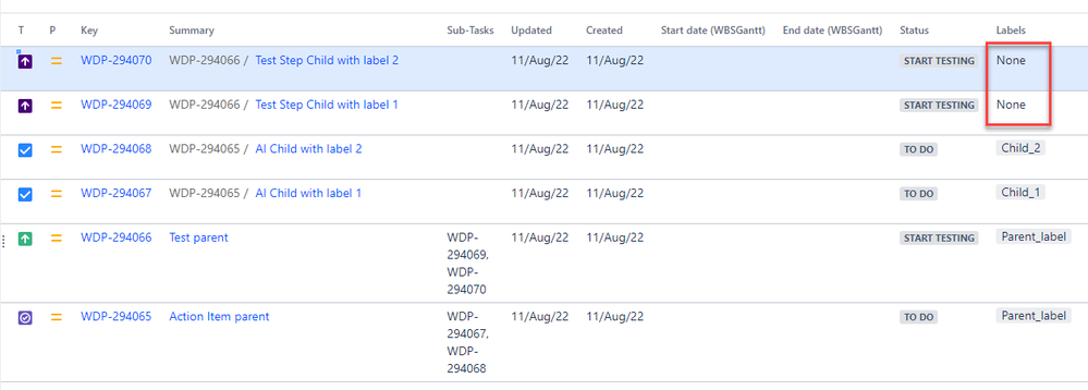

Hi Ram,
I am able to load unique labels on subtasks of action items. I'm unable to do the same on our Test and Test Step (subtask) issue types. See below CSV and screen shot.
Issue ID,Issue Type,Summary,Parent ID,Labels,Test Type
AI-001,Action Item,Action Item parent ,,Parent_label,
AI-002,Subtask,AI Child with label 1,AI-001,Child_1,
AI-003,Subtask,AI Child with label 2,AI-001,Child_2,
Test-001,Test,Test parent ,,Parent_label,Unit Test
Test-002,Test Step,Test Step Child with label 1,Test-001,Child_1,Unit Test
Test-003,Test Step,Test Step Child with label 2,Test-001,Child_2,Unit Test

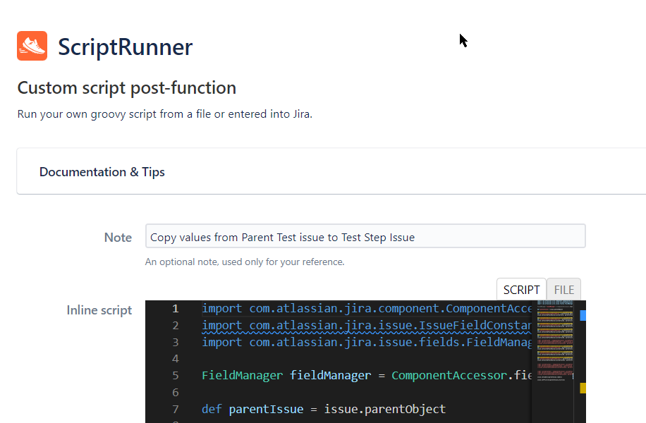

Hi @Ram Kumar Aravindakshan _Adaptavist_ ,
I used to have code in my postscript to copy down the labels from the parent to child:
issue.setLabels(parentIssue.labels)

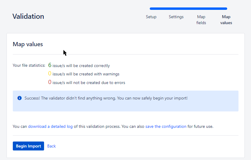

Hi @LaurieC

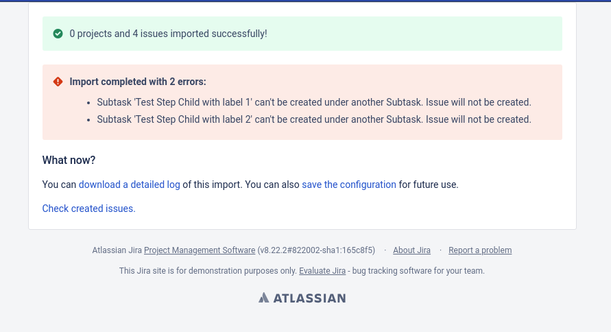

I need to clarify with you, i.e. can you confirm that when you import the issues via the CSV, you are not encountering any errors?
I have tried to import the CSV that you have shared, and I keep getting this error message:-
Only 4 out of the 6 issues are created, and two subtasks are ignored.
Please share if there is any other configuration required.
Thank you and Kind regards,
Ram
Thanks for your continued help. I just tested the file and I'm able to load it.
