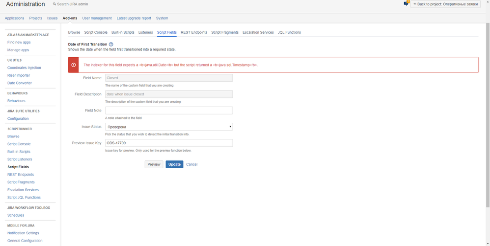

I need to use Date of First Transition but get error
The indexer for this field expects a <b>java.util.Date</b> but the script returned a <b>java.sql.Timestamp</b>.

Not. This is a built-in script that sets the value of customfield by the date of the first transition to the status. Now this script does not work due to data type mismatch. If I had found the script source, I would correct the error.

Providing a screenshot would be helpful.
