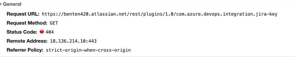

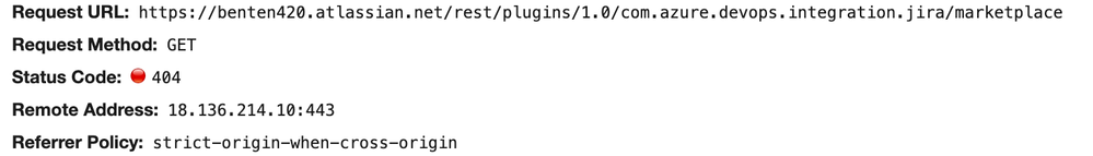

In devtools I can see the failures below:

Once this has been said, I am able to reproduce the issue on all my instances. Free or commercial license doesn't matter, you always get the same error and in Jira logs I can see:
Error contacting remote application 500:[Internal Server Error]:{"$id":"1","innerException":null,"message":"TF400898: An Internal Error Occurred. Activity Id: 9fde909a-c715-4ffa-a171-1f334a1637a7.","typeName":"Microsoft.Azure.KeyVault.Models.KeyVaultErrorException, Microsoft.Azure.KeyVault","typeKey":"KeyVaultErrorException","errorCode":0,"eventId":0}
As you can read the error is returned by the remote application and, actually, TF400898 is a general error which could wrap almost any kind of server-side TFS error.
Therefore, you may want to get in touch with the vendor using the resources listed in the support tab of the marketplace page for the app:

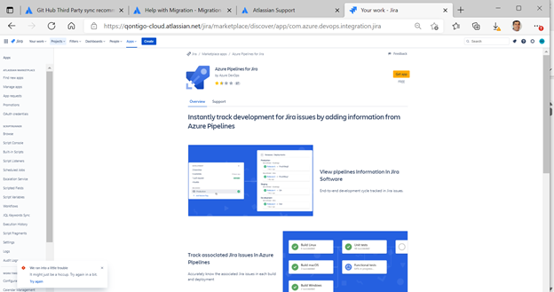

Hi @Jyotsna Singh and @Dario B I tried to Get the "Azure Pipelines for Jira" from the Atlassian Marketplace to get installed in our Jira Cloud instance but failed with the following error:
"We run into a little trouble
It might just be a hiccup. Try again in a bit"
Can you tell how should I get this fixed to continue with the installation pls?
