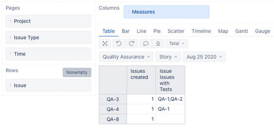

After updating the eazyBI advanced settings, head to the import options "Custom fields" tab, and select the "Issue Tests" for import as a dimension and property. After the import you can create a similar report to the one below:

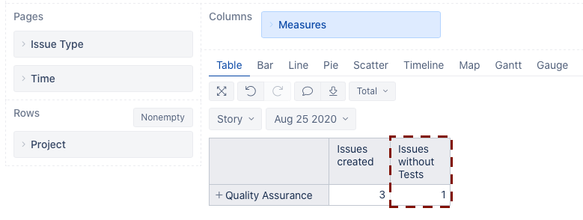

In the report, you can see that two stories created on Aug 25 have linked tests, and one doesn't. You can also create a new calculated measure that would return the number of issues without the links on a broader level. See the formula below:
Sum(
Filter(
Descendants([Issue].CurrentHierarchyMember,[Issue].[Issue]),
IsEmpty([Measures].[Issue Issues with Tests])
),[Measures].[Issues created]
The report then could look similar to the one below:
