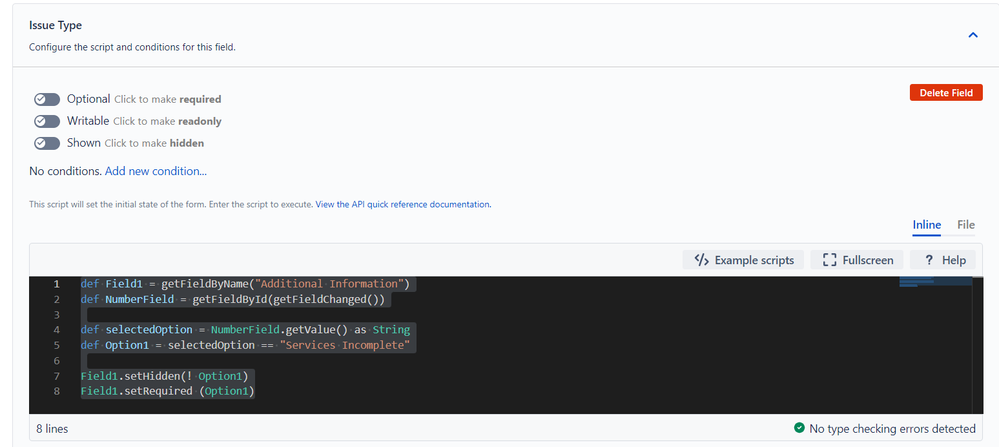

Dear community,
I am trying to configer a behavior in the way that "Additional Information" field is hidden if the issue type is not "Serives Incomplete" and set "Additional Information" field  as required if issue type is "Serives Incomplete".
The issue type is present in a transition pop-up together with the Additional information field but it doesn't seem to work. My code in behaviors is as follows:
def Field1 = getFieldByName("Additional Information")
def NumberField = getFieldById(getFieldChanged())
def selectedOption = NumberField.getValue() as String
def Option1 = selectedOption == "Services Incomplete"
Field1.setHidden(! Option1)
Field1.setRequired (Option1)
Could you please advise?
Best,
Iryna

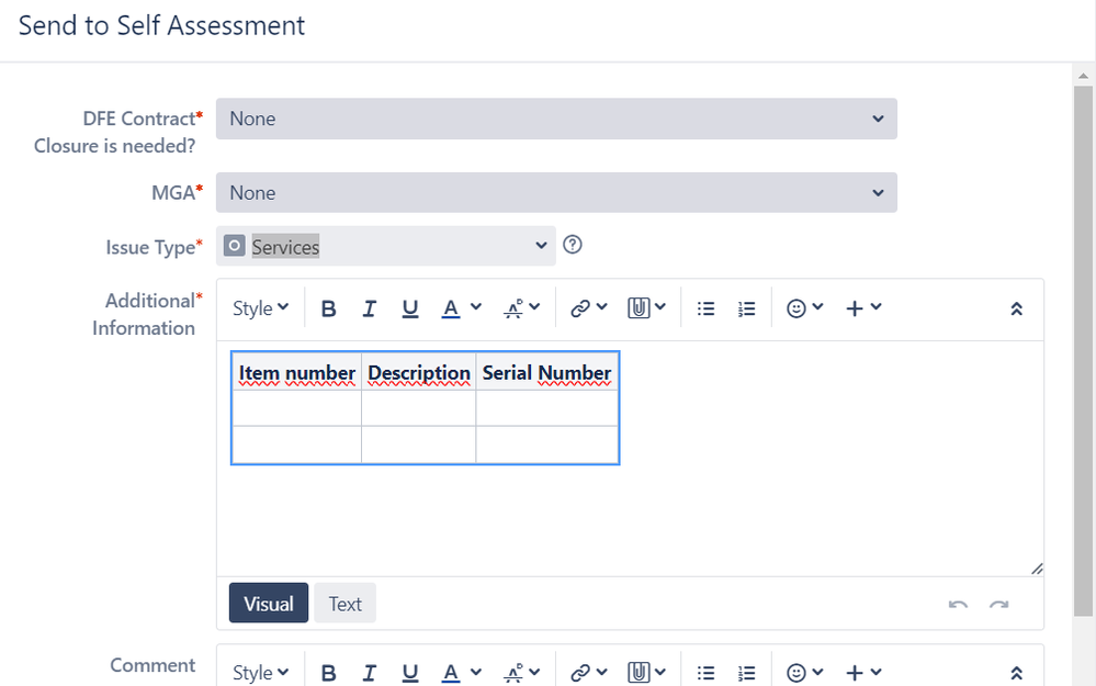

Iryna Pazharytskaya June 12, 2024
But if I change it to :
import com.onresolve.jira.groovy.user.FieldBehaviours
import groovy.transform.BaseScript
@BaseScript FieldBehaviours behaviours
def sampleTextField = getFieldByName('Additional Information')
sampleTextField.hidden = false
sampleTextField.required = true
if(issueContext.issueType.name in ['Services Incomplete']) {
the Additional Information field is always reuired (see the AIrequired screenshot)

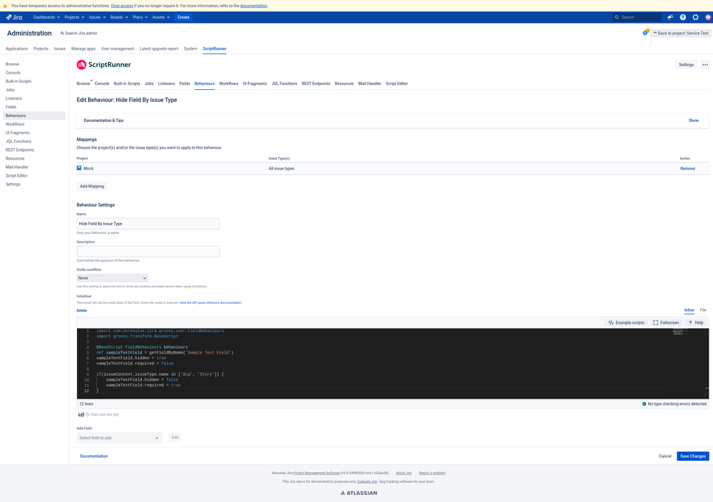

Ram Kumar Aravindakshan _Adaptavist_
June 11, 2024
Hi @Iryna Pazharytskaya
The approach you are trying will not work as expected.
Since you want to make the change based on the issue type, you must use the Behaviour Initialiser instead of the Server-Side Behaviour.
Below is a sample working code for your reference:-
def sampleTextField = getFieldByName('Sample Text Field')
sampleTextField.hidden = true
sampleTextField.required = false
if(issueContext.issueType.name in ['Bug', 'Story']) {
Please note that the sample working code above is not 100% exact to your environment. Hence, you must make the required modifications.
Below is a screenshot of the Behaviour configuration:-
I hope this helps to solve your question. :-)
Thank you and Kind regards,
Ram
Hi Ram,
Thank you for your reply.
If I set it to :
the Additional Information field is always reuired (see the AIrequired screenshotAIrequired.png
But when i set it to:
if(issueContext.issueType.name in ['Services'. 'Supplies']) {
the Additional Information field is always hidden (see the AIhidden screenshot
Looks like it only looks into the line with 'True' in it and doesn't check what type of issue it is (there are 3 possible Issue types:
Supplies,
Services
Services Incomplete
