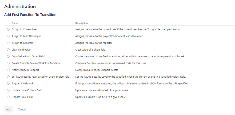

I don't see Deep Clone in the post function. I am using Jira Cloud.
