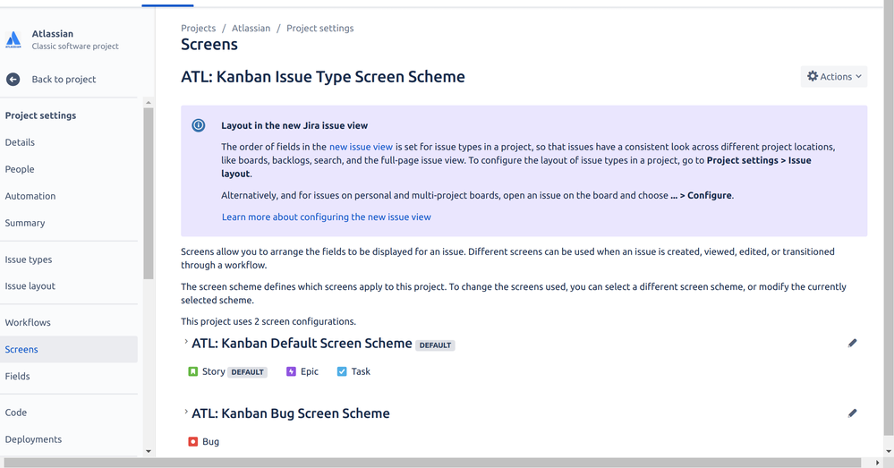

I assume you are using a classic project not a next-gen and test case is an issue type. If my assumption is correct, you need to set another screen scheme for that issue type and use different screens. See this screenshot:

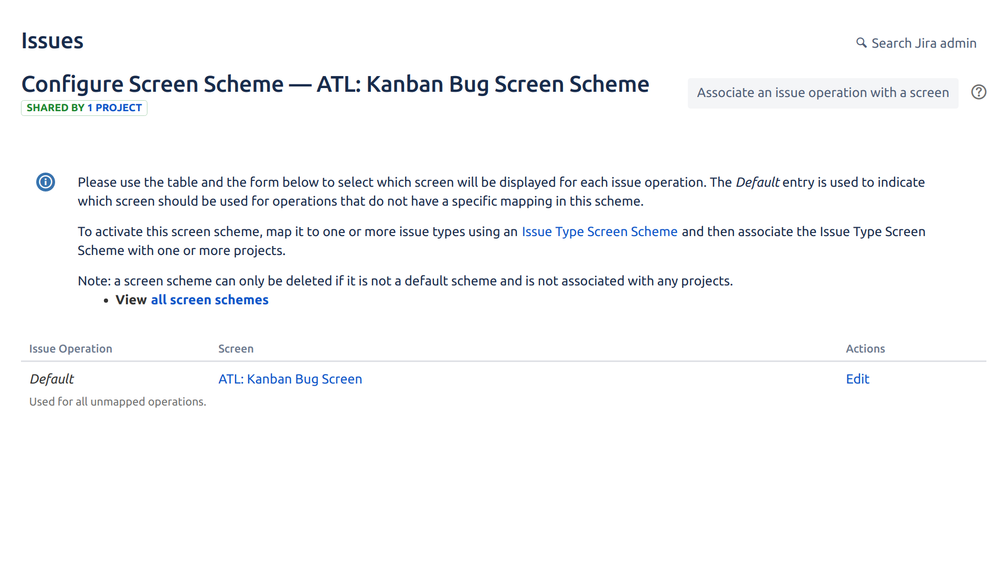

Here bug issue type uses a different screen scheme. When I click on the pencil button next to it, I can see the screen this scheme uses:
Here I can click on edit and use a different screen. First you need to create a different screen, of course. See the button "Associate an issue operation with a screen". Here you can add different screens to different operations like create, edit and view.
Hope this helps.
