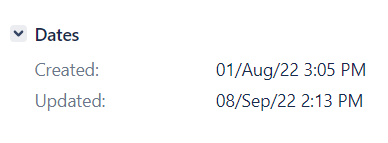

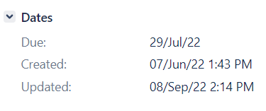

No I do not see it when its created, until I set a due date.
When created:
When updated with a due Date:
So, that explains the error you see - you cannot set something into Jira issue that does not exist...
And the field must exist/be visible on the Jira issue create screen to be settable
