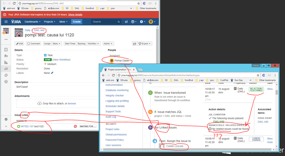

Pompi Diplan August 10, 2017
Hi Andreas,
Is it possible for Jira Project Automation (I have the extended, payed version) to not have access to cross-project links when one of them is ServiceDesk? I am following the very steps you indicated to Sheena above (see picture).
in my case
Sheena's Design = DAIL
Sheena's Purchansing = MITSD
and, for linked Issues which happen to be in my MIT-S[ervice ]D[esk] project the rule falls short of applying with "No related issues could be found". This is pretty surprising - the more so as I put myself as the actor and the owner of the rule and I am an agent authorized to use the Service Desk (MITSD) project. Please tell me I am Capture.PNG doing something wrong :).

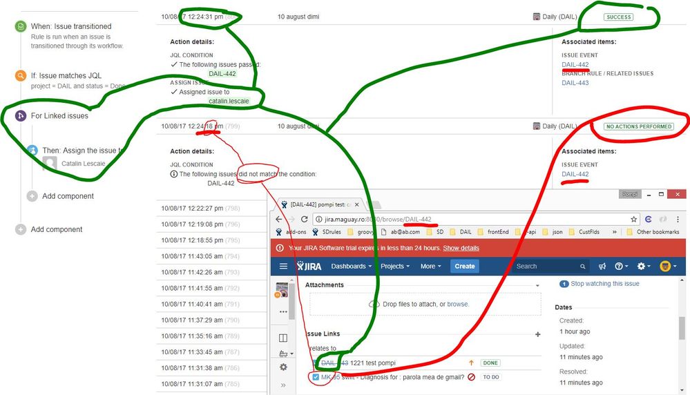

It seems to be an issue not with Service Desk, but with cross-project linked issues detection (the rule branching).
Additionally, if you look at my second snapshot below, I have a case where an issue (Dail-442) is linked to a "close" (i.e., same-project) Dail-443 issue and to a "far" (= different project) one, MK-95. When the same rule applies, at 13 sec. interval:
Dail-443 (the same-project sibling) is considered worthy of being a "match" for the LInked Issues rule (see highlights in green, 12;24;31", with success and follow thru with the Then-action.
MK-95 (the different-project sibling) is considered a non-match (see in red, same minute @ 18") and No-Actions-Performed.Capture.JPG
andreas
August 10, 2017
Hi Pompi,
Thanks for the detailed screenshots.
So it looks like your rule is setup correctly in global admin so it should be able to find related issues in another project.
Can you check your releated issues action though to see if the 'Only include issues that have changed since the last time this rule executed' is checked? You might have to uncheck this.
I believe the second screenshot with issue DAIL-442 shows something different - the first execution with id 799, DAIL-442 didn't match the JQL condition, so it probably wasn't in the 'Done' status yet.  The rule never executed the related issues action.  (In action details it only mentions the JQL condition)
Hope this helps.
Cheers,
  Andreas
Pompi Diplan August 17, 2017
Hi Andreas,
Thank you for your attention (and prompt answer).
I figured out that the rule was, quite contrarily, setup _Not_ in the Global context -my bad- but in the DAIL[Y] project - as one can see from the first screenshot (see the blue Chrome window, under my Exo-ops bookmark). That was the simple reason why it was not working with cross-project linking :). Sorry for randomizing you with a "by design" issue :).
andreas
August 17, 2017
Hi Pompi,
Ah right - that makes sense.  Yeah no worries. Rules need to be 'global' in rule details in order to touch multiple projects.
Cheers,
 Andreas
