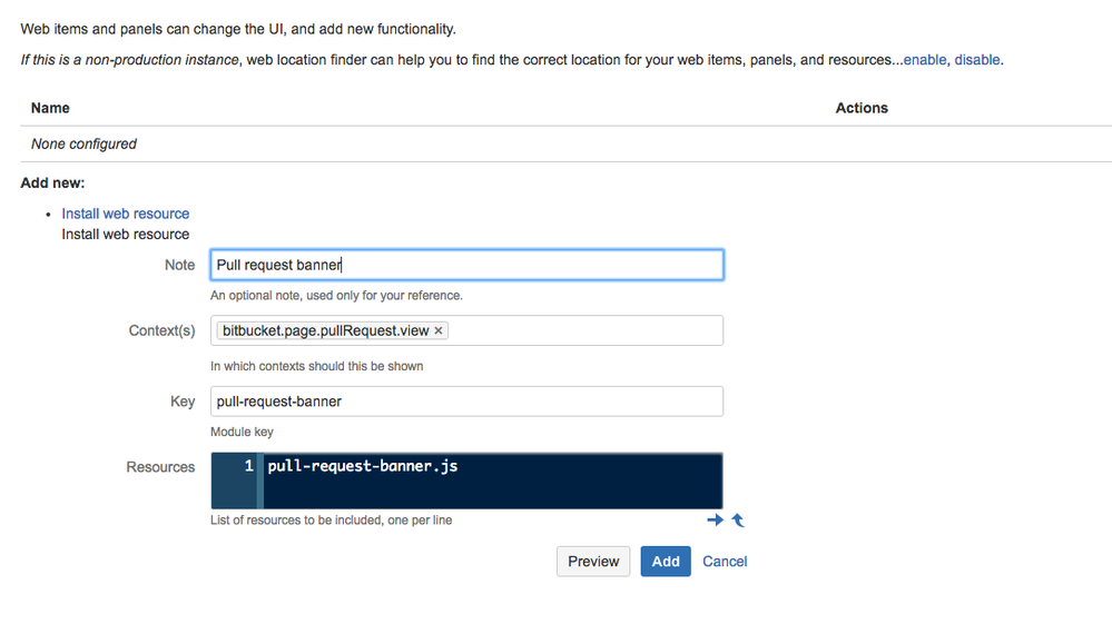

First you need to install a web resource by going to: Admin -> ScriptRunner -> Script Fragments -> Install web resource. The configuration should look the screenshot below:
The context we have specified above ensures this resource is only loaded on a view pull request page.

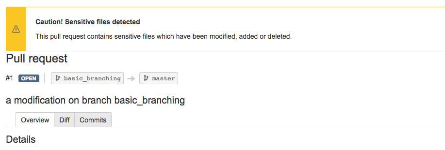

After that when you go to view a pull request which has sensitive files you should see a banner like:
If you follow along, you should shortly have this working. Feel free to comment if you come across any hurdles along the way.
