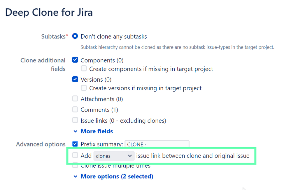

If you don't want to create a link between the original and the cloned issue, make sure to un-check "Add clones issue link" under the advanced options in the Deep Clone dialog.
