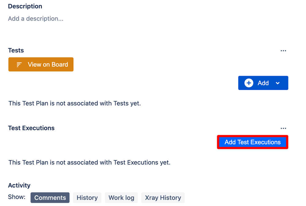

I was able to link a `Test Execution` to the `Test Plan` using another endpoint from Jira Rest API, but I'm looking to add it instead, check the screenshot below for reference. Any help will be appreciated!

Hi @Manuel Abascal ,
you're using an internal API. You should use the public API for that, which is the GraphQL one.
Please have a look at this call.
Please note that if you want to do this association while importing test automation results, it would be possible depending on the REST API call you make. Further info here.
