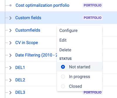

You'll soon be able to change the status of a program by mouse right-clicking it, from the context menu.

Currently, the status of a Program Increment or Iteration can be changed from 'Not started' to 'In progress', to 'Done' in the Roadmap or Board module, by pressing the 'i' button, see fig. 1.
Starting BigPicture 8 (to debut in mid-2020), you'll be able to change the statuses by right-clicking a PI or iteration in the Overview home screen, see fig. 2.
Fig. 1
Fig. 2
