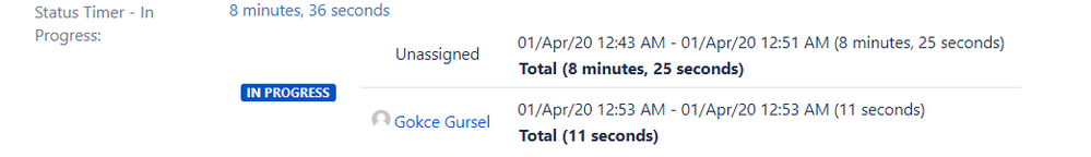

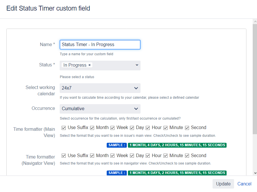

For Server and Data Center, Enhancer plugin satisfies this requirement easily. Status Timer Field measures how much time an issue spends on a particular status and gives you drill-down information that which assignee spends how much time in that particular status. Enhancer is robust, easy to use, and has many useful features.
You can also use calendars and different calculation methods for the Status Timer. Moreover, the Status Timer custom field can be added to Jira reports for further analysis.

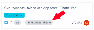

Also, you can find workflow bottlenecks with Time in Status for Jira Cloud. It generates reports about time issues were at each status.
Time Between Statuses lets calculate status to status time data. Its feature is that using it, you can set time limits and notifications, so as not to miss the problem of space in tasks.
