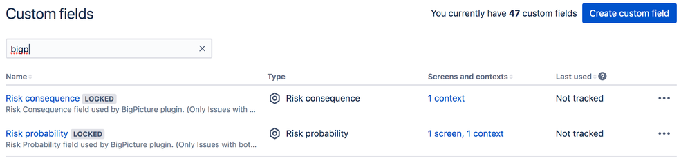

Any answer will be helpful on how to complete the uninstallation in the cloud version.
2 custom fields remain and are marked as LOCKED.

sai siva December 13, 2021
@Milan Chheda [INFOSYSTA]
How can if find custom field created by BIG-Picture Add-on.
Anna-BigPicture
December 13, 2021
Hi @sai siva
You can find custom fields created by BigPicture by navigating to Jira administration (cog icon) > Issues > Custome fields and search by SoftwarePlant or BigPicture.
You can find the complete list of fields created by the App in our wiki here.
