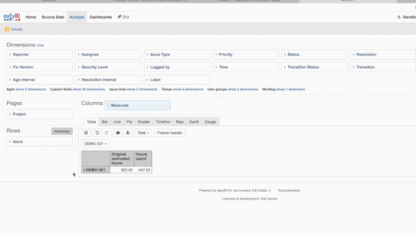

Perhaps you don't need to create calculated member at all in this case
You could set the filter on original estimated hours column while being at Project level and then drill into issues would not even show issues without original estimated hours.
See the attached gif.
Martins / eazyBI support
